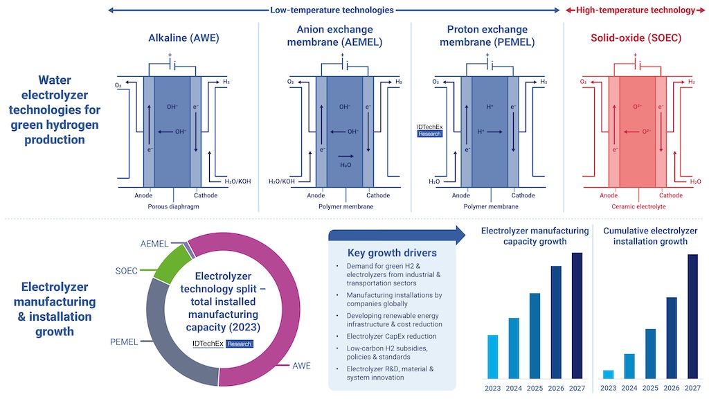

Water electrolyzer technologies for green hydrogen production and electrolyzer manufacturing and installation growth.
Water electrolyzer technologies for green hydrogen production and electrolyzer manufacturing and installation growth. Courtesy: IDTechEx

Different types of water electrolyzers & key technological developments
There are four main types of electrolyzer technology that can be used to produce green hydrogen: alkaline water (AWE or AEL), proton exchange membrane (PEMEL or PEMWE), anion exchange membrane (AEMEL or AEMWE), and solid oxide electrolyzers (SOEC or SOEL). Each technology comes with its own set of performance characteristics, commercial maturity, and various advantages and limitations. IDTechEx’s market report, “Green Hydrogen Production & Electrolyzer Market 2024-2034: Technologies, Players, Forecasts”, provides an analysis and comparison of the different electrolyzer systems available, covering working mechanisms, materials employed, and system performance, amongst other factors.
Alkaline water electrolyzers (AWE) have long been commercial and used for industrial applications. They are characterized by their lowest capital costs (CapEx) and longer stack lifetimes compared to other technologies. They are also the most mature in terms of manufacturing, with large gigawatt-scale production facilities operating globally. The combination of these factors makes them a popular choice for large-scale green hydrogen projects.
PEM electrolyzers (PEMEL) are characterized by higher power densities and output hydrogen pressures, as well as faster response times than alkaline systems. This generally makes them better suited to coupling with renewable energy sources directly. PEMEL systems previously lagged behind AWE commercially but are now ready to compete with AWE systems in green hydrogen project installations. PEMEL systems remain more expensive than AWE, but the last few years have seen a larger number of projects adopting PEMEL technology, although of smaller system size compared to AWE.
SOEC is a relatively recent electrolyzer technology to reach commercial deployment, driven by advancements in solid oxide fuel cells (SOFC). Operating at high temperatures (>600°C), they offer higher system efficiencies but are expensive and require further improvements. However, their higher temperatures and efficiency compared to low-temperature technologies offer several advantages. For example, SOEC systems can reuse waste process heat and co-electrolyzer H2O and CO2-producing syngas, which makes them well-suited for coupling with industrial applications.
AEMEL is the youngest and least commercially mature technology on the market. AEMEL aims to combine the benefits of AWE and PEMEL systems – low-cost and abundant materials of AWE with the higher efficiencies and dynamic response rates of PEMEL. The number of players developing AEMEL is limited, but it is likely to gain more market players and presence in commercial green hydrogen projects.

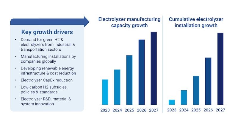

Future growth drivers on the water electrolyzer market
Certainly, growth in the electrolyzer market across all four electrolyzer types will be needed to meet ambitious national and regional targets for green and clean hydrogen production. Ultimately, one of the most important parameters is likely to be the levelized cost of hydrogen (LCOH), which is heavily influenced by the price of renewable electricity as well as the capital cost (CapEx) of the green hydrogen plant.
IDTechEx expect that key drivers behind LCOH reduction will be improvements in electrolyzer technology and scaling up of manufacturing facilities, which will ultimately lead to CapEx reductions. More importantly, securing low-cost renewable electricity, establishing hydrogen off-take agreements, and obtaining government grants, tax credits, and subsidies will be critical for the commercial viability of green hydrogen projects and further LCOH reduction.
