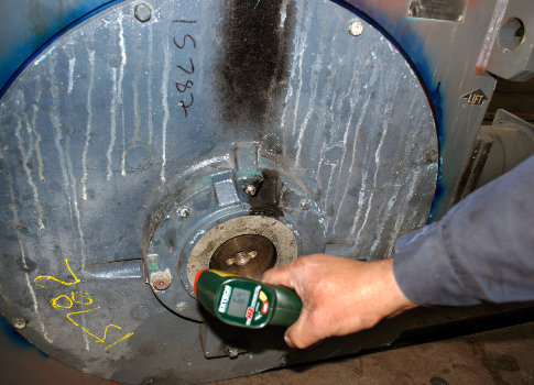

Using a digital infrared thermometer to check motor bearing temperature can help monitor winding temperature.
“We had a motor rewound, and now that it’s back in service it’s running hot. The frame is getting so hot that we can’t put our hands on it. Did the service center rewind the motor incorrectly?”
Has this ever happened to you? After installing a freshly rewound motor, your maintenance crew tells you it’s running hot. Although no design change was involved and the test results look good, you’re on the verge of calling the service center to demand another rewind.
Before picking up the phone, though, you should investigate for yourself to see if there’s really a problem. Quite possibly the motor always ran “hot,” even when it was in good working order. It’s also unlikely that anyone on-site ever checked for this by touching the frame.
You can’t tell by frame temperature
There’s no way to determine the winding temperature of a motor just by feeling the frame. Good practice and safety considerations dictate that the temperature of any part of a motor should be checked with a temperature measuring device. The maximum temperature rating, based on the class of insulation, applies to the winding temperature at the hottest spot inside the motor. As a general rule, the temperature of the frame can be 20 to 40 C cooler (less or more), depending on the design of the frame and the enclosure.

The best way to determine if a motor is running within a safe operating temperature is to monitor its winding temperature with temperature sensors like thermostats or resistance temperature detectors. As mentioned before, you can also monitor the current to get a basic idea of how the motor is running.
Relying solely on the surface temperature of the frame, however, is not an accurate or safe way to determine the “safe” operating temperature of the motor winding.
