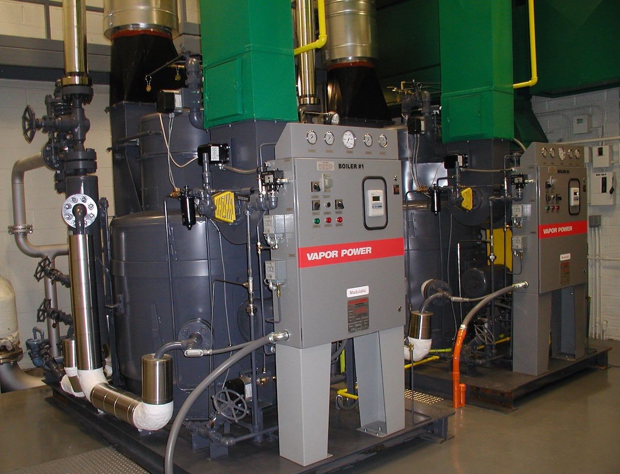

A safety valve manufacturer in Farmingdale, N.Y. uses two 200 bhp Modulatics once through watertube boilers because of their unique combination of low flow and high pressure, which work well for safety valve testing. Courtesy: Vapor Power International[/caption]
The Modulatic from Vapor Power International is a once-through watertube boiler with a positive displacement pump that provides a constant feedwater supply. The fuel/air ratio curve changes the amount of fuel and combustion air in direct proportion to the flow of water being sent to the coils. According to Glenn A. Kuhlman, Midwest regional sales at Vapor Power International, 90% of the water is converted into steam in the coils. Dry steam is then produced in the steam separator. The water remaining is removed by a steam trap.
