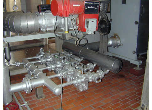

In Figure 1, the red circles show improper connection to the condensate header, which generates a thermal shock type of water hammer. Instead of connecting into the side of the condensate header, the returns should enter in the top of the manifold (condensate header).

In bi-phase condensate systems, steam bubbles may be introduced below the level of condensate in a condensate line. For example, a branch line from a steam trap station may be piped to the bottom of a condensate main header, as shown in Figure 2.
For example: Steam is introduced into the heat exchanger (P2) at 100 psig or 338 F and condensate at P3 will be 338 F. When the condensate passes through the steam trap station at P4, which at a lower pressure a percentage of the liquid will flash to steam due to the low pressure/temperature relationship. When the flash steam bubble flows to P5 and is introduce below the condensate level in the condensate piping, the thermal differences will cause the flash steam bubble to collapse. During the collapsing, the water is accelerated an extremely high speed due to the vacuum that occurred when the bubble collapsed. The result is a pinging sound or when there is large quantity of flash steam (bubble is large) a very sharp banging sound.
Solutions:
Connecting into the condensate header All condensate system branch lines must be connected into the top of the main condensate header: there is no exception. The condensate connection is at the top on the horizontal condensate main header and never into a vertical condensate header.
