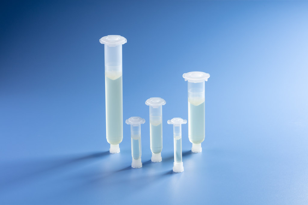

Figure 1: Optimum Class VI dispensing components include 3cc, 5cc, 10cc, and 55cc barrels, pistons, end caps and tip caps. Courtesy: Nordson EFD

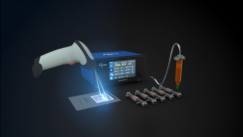

Figure 2: Bar code scanning of medical device components permits access to stored dispensing programs, reducing human error. Courtesy: Nordson EFD

The consistency and repeatability performance of precision dispensing systems goes beyond the actual dispensing equipment itself and is also dependent upon the quality and proper usage of the system components. These consumable plastic components – syringe barrels, adapter assemblies, pistons, caps and dispense tips – are designed to meet the requirements of different types of fluids and applications, and to dispense the most precise fluid deposit possible.
To achieve the highest level of performance from these dispensing systems, several requirements need to be inherent in their manufacture and usage:
  1. Each of the consumable plastic components should be designed as part of a complete, integrated system. This will improve yields and reduce costs by producing the most accurate, repeatable fluid deposits possible. Mixing and matching components from different systems or suppliers is a recipe for diminishing performance.
  2. The dispensing components should always be used as single-use consumables. In high-precision dispensing systems, barrel IDs (internal diameters) and piston diameters, as well as dispensing tips, are manufactured with tolerances that make any residue from prior dispensing residing in the barrel, piston or tip degrade dispensing repeatability performance. Once the piston reaches the bottom of the barrel, the barrel, piston and tip should be discarded.
  3. Maintaining precision and shot-to-shot repeatability in dispensing starts with quality manufacturing of the components. For best performance, all components should be certified that no silicone mold-release agents are used in the precision molding process, or at any other time during the production of the dispensing components.
  4. Some dispensing solution providers, such as Nordson EFD, also provide a complete dispensing component system molded from medical-grade United States Pharmacopeia (USP) Class VI resin. These syringe barrels, pistons, and end and tip caps are designed to simplify process validation for medical manufacturers. These and even standard dispensing components can be sterilized prior to use in medical device manufacturing.

Traceability: Most medical device components have a unique barcode assigned to them as they move through the production/assembly process to facilitate keeping track of the components throughout production – a system often utilized by industries other than medical device manufacturing for six sigma process controls.
New to the world of fluid dispensing is the unique capability to switch between stored dispensing programs using nothing more than a barcode scanner. This allows the operator to change the parameters for a new application without touching process parameters on the touchscreen of this new benchtop fluid dispenser. The dispenser settings automatically switch when the new program barcode is scanned.
The days of maintaining dispensing parameters in handwritten spreadsheets and notepads, and manually entering coordinates into the dispenser on subsequent runs is now in the past, greatly reducing the possibility of human error in setting dispensing parameters.
Another unique feature is a digital dispense log, which automatically records data on dispense parameters – such as dispense time, pressure, vacuum, and the date, day and time of each dispense cycle. Downloadable manually through the dispenser’s USB port, the dispense log is beneficial to manufacturing processes that require stringent, documented process control, especially in life sciences applications to meet FDA or MDR (Medical Device Regulation) requirements, or that of other global medical device regulatory bodies.

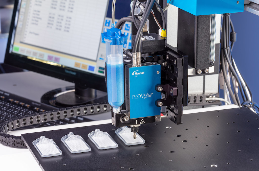

Figure 6: Pico Pulse jet valve dispensing medical fluid onto dialysis filters with a 37ga ceramic MicroDot dispense tip. Courtesy: Nordson EFD
Process control: The ability to set the time, pressure, and other dispensing parameters for an application improves process control and ensures the right amount of fluid is placed on each part.
The latest generation of benchtop dispensers provides a high degree of process control for dispensing applications in the assembly of medical devices, capable of dispensing adhesives, solder pastes and all other assembly fluids with high consistency.
Fluid dispensing of dots, beads and fills can be achieved with dispensing equipment features such as a 1-100 psi air pressure regulator, timed-shots, vacuum control to keep thin fluids from dripping, digital time/pressure displays and electric foot pedals.
Additional features include: a) time adjustment as fine as 0.0001 seconds; and b) constant-bleed air pressure regulation (offered with Ultimus I and II dispensers) for reliable control when dispensing any type of fluid.
Some of the latest fluid dispensers allow programmable sequencing to automatically adjust dispensing parameters, making them ideal for applications that involve two-part epoxies and other fluids that thicken over time or get thinner as ambient temperatures rise.
Another feature supporting precision dispensing, which is particularly applicable for medical device manufacturers, is Automated Optical Inspection (AOI). When coupled with CCD cameras and confocal lasers, EFD vision guided automation platforms provide optical assurance of fluid deposit volume and placement accuracy ensuring a conforming deposit.
Using the robot’s existing vision systems, the AOI software verifies fluid deposit widths and diameters. With the AOI confocal laser, the system measures the height of a fluid deposit in addition to the width and diameter, providing 3D deposit verification and determines if dispense requirements have been met. The confocal laser detects deposit height measurements regardless of the transparency of the fluid, which can sometimes distort quality data. Constant closed-loop feedback delivers automated quality control data, saving medical manufacturers time and costs.

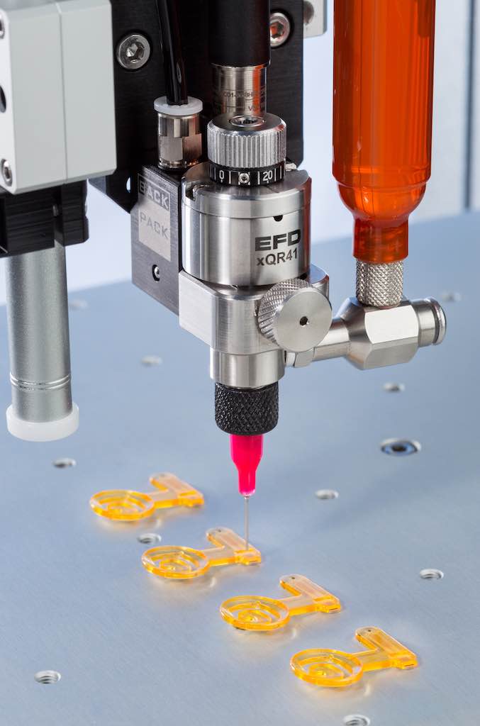

Figure 7: xQR4IV needle valve dispensing UV-cure material onto a medical device. Courtesy: Nordson EFD

Figure 8: xQR4IV needle valve dispensing UV-cure material onto a medical device. Courtesy: Nordson EFD
