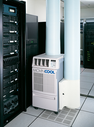

Even in the most temperate climate, a production plant with no need for central air conditioning is still likely to require cooling for nonmanufacturing areas such as server and equipment rooms, office suites, and conference rooms. Sometimes this is accomplished through permanently installed air handling equipment, but portables often play a role in these applications. They can offer a faster, easier, and/or more cost-effective solution than mini-splits or other unitary air conditioning systems.
The term “portable” need not be synonymous with “temporary.” Portable equipment is often installed on a permanent basis to provide primary cooling to offices and server rooms, or to deliver supplemental cooling to growing facilities where the primary HVAC system is no longer adequate or hot spots are a problem. This situation is especially prevalent in server rooms, which can present challenges as they become densely packed with more heat-generating electronics. A typical cost comparison might reveal that a portable 5-ton cooler can deliver supplemental cooling to a server room for under $10,000, where a permanently installed solution might cost four to five times as much to cool the same space.

For server and equipment rooms, similar calculations apply, but the loads can be very heavy due to the high heat generated by such equipment. If the room uses a UPS backup battery, you can actually take the battery wattage (i.e., 6000 watts) and multiply by 3.413 to arrive at the amount of Btu/hr or cooling needed for a “worst-case” scenario. It might result in overkill, but server rooms are one of the few applications in which overspecification actually tends not to be a problem.

If the portable cooling must be located outside the room due to floor space constraints, safety, heat rejection, or other concerns, you will need to find a way to duct the evaporator return and cold air supply in and out of the room to be cooled. This might involve cutting openings in the drywall to insert ductwork or, for temporary solutions, ducting the cold air in and out over the wall by removing ceiling tiles.
Often a portable unit will be used to cool an office, server room, clean room, or other small enclosed space within a warehouse. If it is a large facility with high ceilings, the hot air can usually be discharged up toward the warehouse ceiling with minimal effect on the rest of the building since cold air drops to the floor level. Similarly, in a manufacturing space, the hot air from the spot cooler can be discharged by running a single rigid plastic or flexible duct above workers’ heads to the ceiling, where there is often an exhaust fan to help remove the heat being generated by the air conditioning unit from the space.
If the entire space is to be cooled, a two-duct system can be devised using a condenser plenum on the portable unit with an additional duct, so there will now be two ducts going to the ceiling, window, or door. This creates a closed-loop system that no longer creates a negative pressure. With doors shut, the space can be cooled very efficiently. The air conditioning unit can also be placed outside and the cold air ducted in and out through a doorway or windows.

In some applications, especially server rooms, it will be necessary to run a condensate line out of the room to an external drain of some sort—in a janitorial closet, bathroom floor drain, or perhaps out a window to an outdoor drain. A condensate pump for this purpose can be obtained from your portable cooling equipment supplier.
