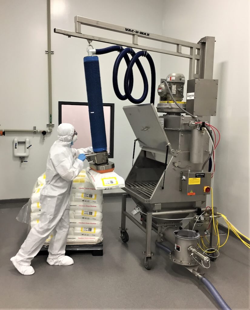

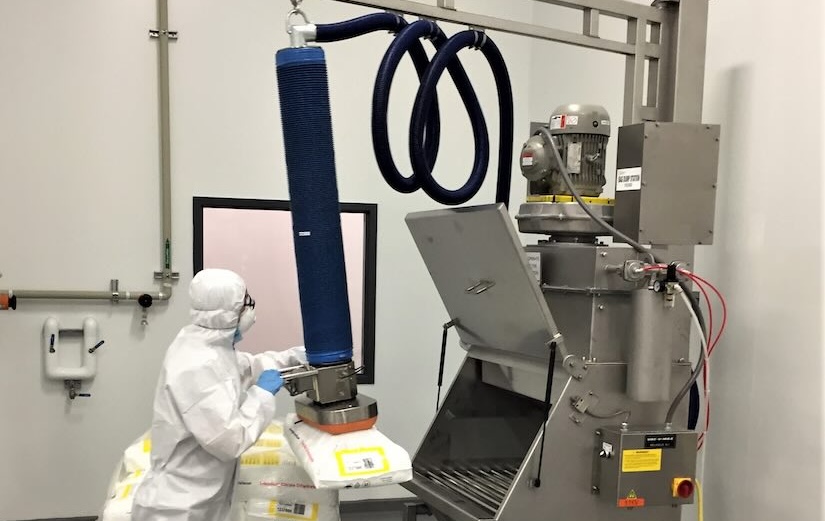

Figure 2: Bag dump station includes vacuum-assisted lifting to reduce exertion and reduce bending/twisting tasks.
Figure 2: Bag dump station includes vacuum-assisted lifting to reduce exertion and reduce bending/twisting tasks. Courtesy: VAC-U-MAX
Personnel also need to be safe from inhalation hazards from fugitive dusts. Manual dumping and filling can expose workers to allergens such as sesame seed dust and milk powders. Other powders such as super-absorbent polymer (SAP) will dry out mucous membranes in the eyes and nose of workers if over-exposed. Workers in certain industries can be exposed to carcinogenic materials such as silica sand through inhalation.
Automation via vacuum conveying of these powders in lieu of manual handling reduce fugitive dusts and unhealthy or life-threatening exposures.
However, if bag dumping cannot be avoided, devices such as bag dump stations with integral dust collectors at the entry point of a vacuum conveying system will draw dusts away from the worker when dumping bags of powder.

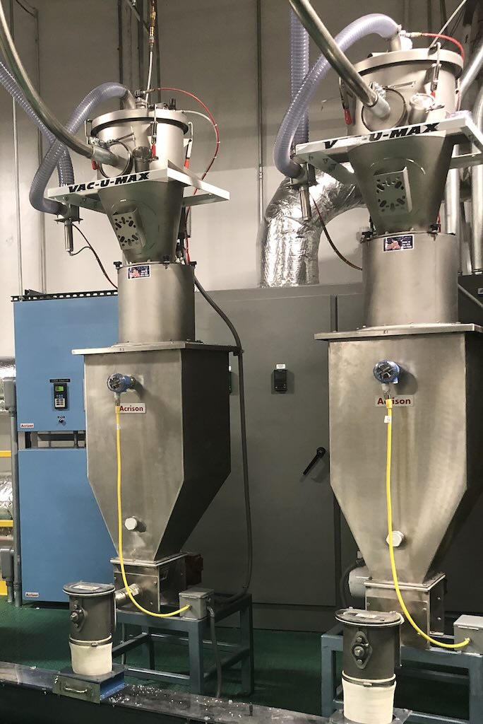

Figure 3: Vacuum conveyor keeps auger-filler packaging machine full with constant head pressure of powder for accurate filled containers.
Figure 3: Vacuum conveyor keeps auger-filler packaging machine full with constant head pressure of powder for accurate filled containers. Courtesy: VAC-U-MAX

Figure 4: Vacuum conveyor with discharge-on-demand sequencing allows highest accuracy from gravimetric feeders.
Figure 4: Vacuum conveyor with discharge-on-demand sequencing allows highest accuracy from gravimetric feeders. Courtesy: VAC-U-MAX

Other powder processing equipment such as loss-in-weight (LIW or gravimetric) feeders are most accurate when the refill time is minimized. Gravimetric feeders convert into volumetric (non-weighing) mode during its fill cycle. Minimizing the refill time maximizes the accuracy of a gravimetric feeder.
Figure 6: Vacuum conveyor technique known as direct-charge blender loading keeps ingredients at floor level and eliminates stair climbing and forklift traffic.
Figure 6: Vacuum conveyor technique known as direct-charge blender loading keeps ingredients at floor level and eliminates stair climbing and forklift traffic. Courtesy: VAC-U-MAX
A vacuum conveyor accomplishes this by holding the next batch of powder waiting for the refill signal from the feeder and immediately discharging the powder. This is known as discharge-on-demand and is a form of immediate gratification in the bulk powder handling industry.

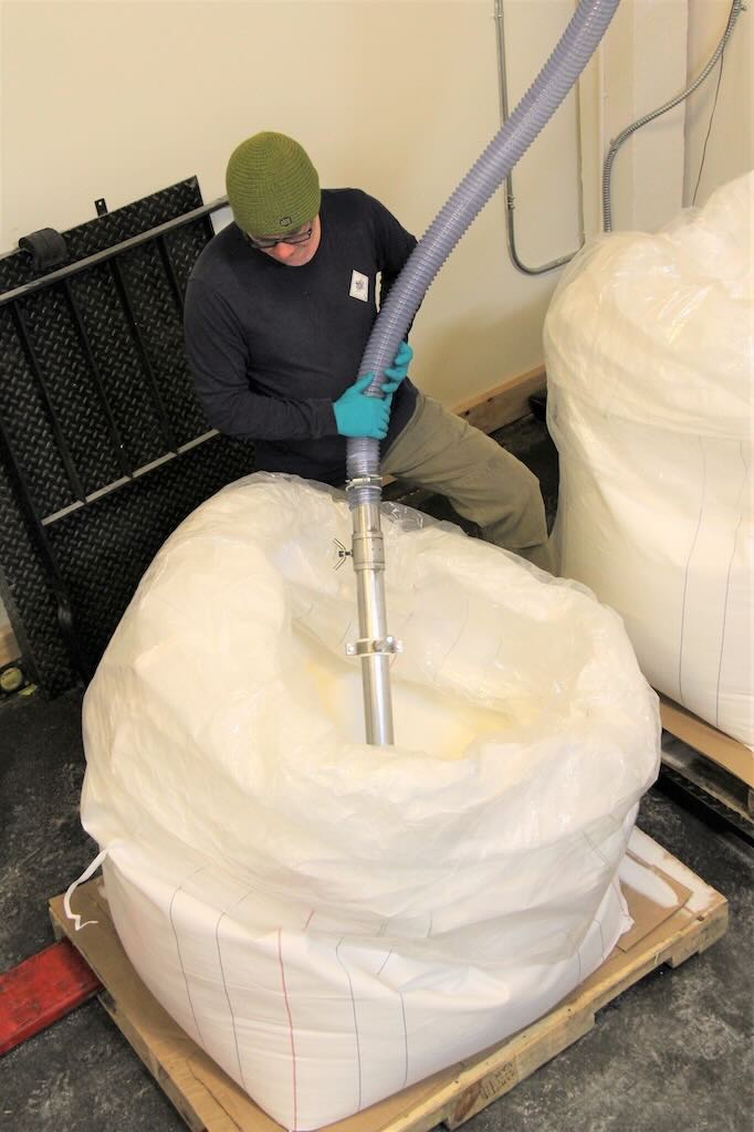

Figure 8: Automated powder handling can begin with bulk bag unloading for lower ingredient costs and better dust control.
Figure 8: Automated powder handling can begin with bulk bag unloading for lower ingredient costs and better dust control. Courtesy: VAC-U-MAX

Figure 9: Volumetric and gravimetric feeders are big beneficiaries of automated vacuum conveying for refill.
Figure 9: Volumetric and gravimetric feeders are big beneficiaries of automated vacuum conveying for refill. Courtesy: VAC-U-MAX
It also can reduce ingredient costs by transitioning from smaller manually dumped containers to larger bulk material containers such as bulk bags and silos. Vacuum conveying is the only bulk powder handling technology that is “container agnostic” and works with any original ingredient container.
