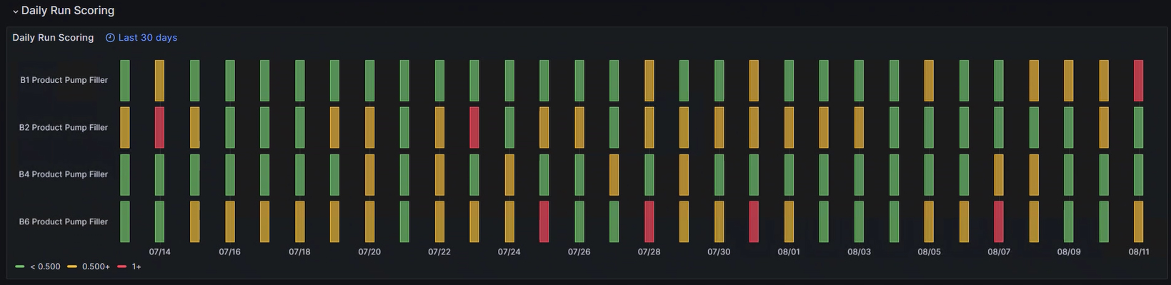

Figure 1: This is an example of a dashboard in a PID loop monitoring tool. The daily run scoring dashboard shows the travel time of each PID loop and displays its green/yellow/red performance over each day. Courtesy: Interstates
Some of the key performance indicators (KPIs) you may monitor in a PID loop tool include cycle time, cycle response, oscillation magnitude, oscillation percent, and settling time. David King, analytics delivery leader at Interstates, compares PID loop monitoring to a car’s cruise control: “You want to accelerate to your target speed quickly but without overshooting or creating oscillation in your car’s speed.”

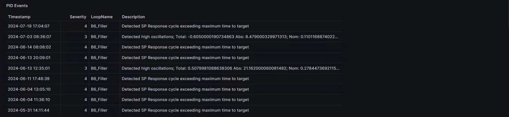

3.     Fault detection: Monitoring loops allow for early detection and diagnosis of system faults, malfunctions or disturbances. This allows personnel to take corrective actions and prevent maintenance issues (see Figure 3).
Figure 3: Users can set up automatic alerts using the monitoring tool. For example, these can be generated when loops drift too far from the set point. Here is an example of that automated report. Courtesy: Interstates

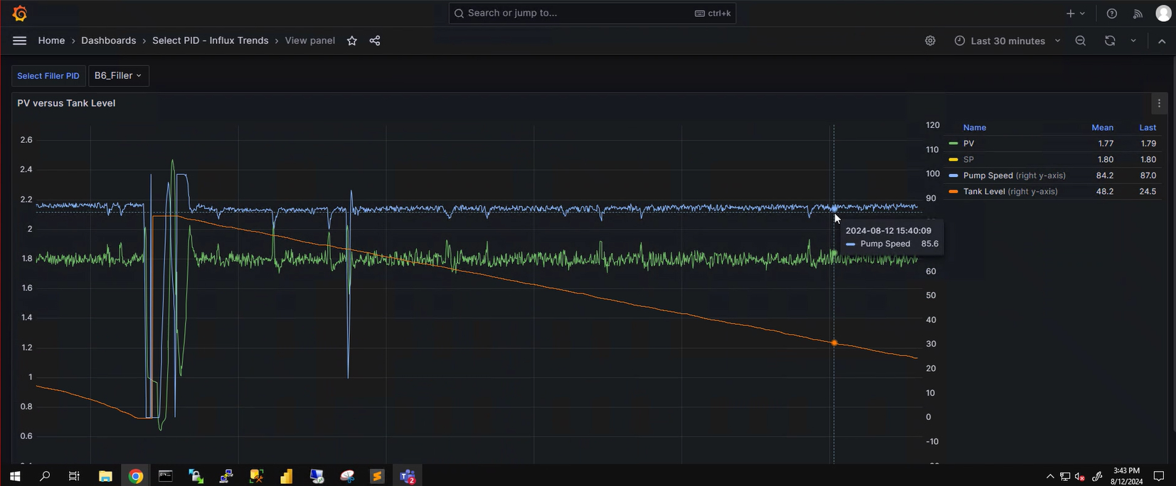

Data shows pressure level inefficiencies
Implementing PID loop monitoring yielded several tangible benefits for the client, including enhanced visibility into critical process variables. One variable was the pressure variation in tanks, which is crucial for maintaining product quality.
Through the data provided by the monitoring dashboard and reports, the client observed minimal pump speed variations when the product tanks were full due to stable pressure levels. However, as the tanks dispensed the product, there were higher variations in pump speed, indicating the need for adjustments based on tank levels.
“The PID loop monitoring tool has enabled us to historically analyze instances where we have had issues filling and allowed us to visualize it in a way that is very similar to our PLC trend. This enables us to solve issues without having to be on the line,” King said.
These insights allowed the client to make precise, data-driven adjustments, ensuring more consistency in the bottle-filling process.

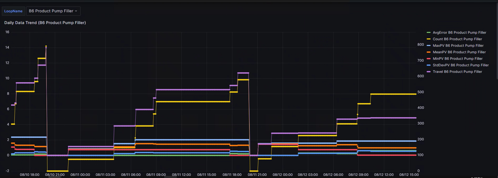

Figure 4: For a quick and easy way to view a summary of PID loop data, users can use the PID loop user dashboard. This displays events and loop performance data from the last seven days. Courtesy: Interstates

Figure 5: Users can see trends in PID performance with additional context from the machine's key indicators. Courtesy: Interstates
Figure 5: Users can see trends in PID performance with additional context from the machine’s key indicators. Courtesy: Interstates
