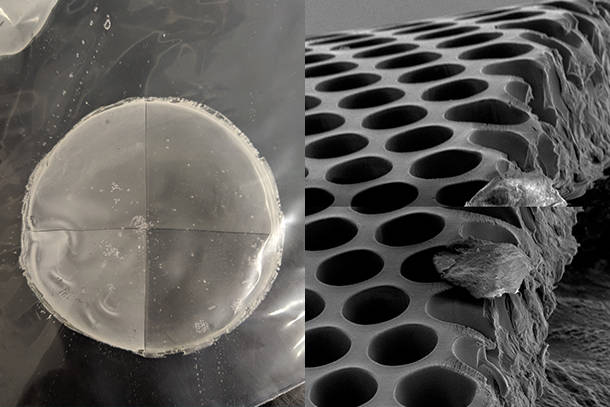

Penn State researchers will fabricate membranes with different surface pattern geometries and sizes to use in membrane capacitive deionization. The full membrane is seen at left, and at right, a portion of the membrane is seen under an electron microscope. The tiny wells allow sodium and chloride ions be filtered out of unclean water Credit: Arges Lab. All Rights Reserved.

To improve MDCI’s effect on more concentrated water sources, Arges and his team will redesign the electrochemical cell module used in MCDI. With tools from the Nanofabrication Lab in the Penn State Materials Research Institute, the researchers will fabricate microscopic wells in an interlocking pattern on the membrane surface. This increases the interfacial area between the membrane and electrodes, improving contact and reducing the distance that sodium and chloride ions need to travel to cross the membrane-electrode interface.
