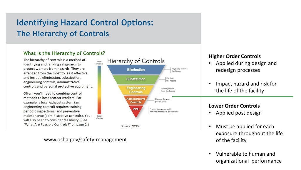

It’s not to say that arc flash doesn’t cause a lot of injuries, I’ve just said that. It’s very important. It’s two distinct hazards and we have to address both of them. Today we’re talking about arc flash. This illustration is from OSHA. If you can go to the URL there that’s shown on the slide and get a lot more information than what I’m showing here on on the screen. But one of the resources on that website is this document titled Identifying Hazard Control Options: Applying the Hierarchy of Controls. And you can see the illustration here from elimination, substitution, engineering controls, administrative controls and PPE and it’s going from the most effective to the least effective. We put a lot of emphasis on PPE, but we need to recognize that there are significant limitations. PPE will not prevent an incident. The PPE will not prevent an incident. It will help reduce the severity of injury if an incident should occur.

Again, that’s why over on the right-hand side, we see what’s called the higher order controls. They’re applied doing design and redesign processes and once they’re put in place in the design of the facility or the production site, they impact the hazard and risk for the entire life of the facility. That’s why they’re so important. The lower order controls below the green line are applied after the facility is built, it’s already been designed. We’ve done everything we can at that point to reduce risk. So now we’ve got to address the remaining risk with these lower order controls. They must be applied for each and every exposure throughout the life of the facility. That can be thousands of exposures and you’ve got to do something each time to mitigate the exposure and the lower order controls are also vulnerable to human and organizational performance. People need to know what to do, do it every time and do it right. All of these controls are extremely important.
