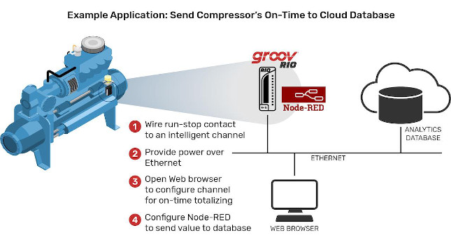

  • Edge I/O can be used for lightweight integration by connecting I/O signals to data networks in parallel with legacy automation systems.
  • Hardwired equipment can be retrofitted with basic sensors and edge I/O as a controller-less integration option that sends data directly to supervisory systems.
  • Existing middleware such as PLCs and Windows PCs can be bypassed or removed by allowing edge I/O to handle data acquisition, preprocessing, and transport to higher-level systems.
  • Since many edge I/O models are designed for hazardous locations, edge I/O also provides a more affordable path to remote condition monitoring of hard-to-reach equipment.
In combination with edge controllers, edge I/O makes available more design possibilities, particularly for integrating legacy automation devices. But it’s the controller-less potential of industrial edge I/O that allows for flexible deployment of intelligence and connectivity into the process. That kind of scalability, with security as a first principle, helps to make large-scale machine-to-machine communication feasible.
