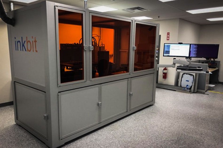

The company is accomplishing this by pairing its multimaterial inkjet 3-D printer with machine vision and machine learning systems. The vision system comprehensively scans each layer of the object as it’s being printed to correct errors in real-time, while the machine-learning system uses that information to predict the warping behavior of materials and make more accurate final products.

At MIT, Matusik’s research group used a 3-D scanner to track its machine’s progress. For Inkbit’s first printer, the founders wanted to dramatically improve “the eyes” of their machine. They decided to use an optical coherence tomography (OCT) scanner, which uses long wavelengths of light to see through the surface of materials and scan layers of material at a resolution the fraction of the width of a human hair.
Because OCT scanners are traditionally only used by ophthalmologists to examine below the surface of patients’ eyes, the only ones available were far too slow to scan each layer of a 3-D printed part — so Inkbit’s team built a custom OCT scanner.
When a layer is printed and scanned, the company’s proprietary machine-vision and machine-learning systems automatically correct any errors in real-time and proactively compensate for the warping and shrinkage behavior of a fickle material. Those processes further expand the range of materials the company is able to print with by removing the rollers and scrapers used by some other printers to ensure precision, which tend to jam when used with difficult-to-print materials.
The system is designed to allow users to prototype and manufacture new objects on the same machine. Inkbit’s current industrial printer has 16 print heads to create multimaterial parts and a print block big enough to produce hundreds of thousands of fist-sized products each year (or smaller numbers of larger products). The machine’s contactless inkjet design means increasing the size of later iterations will be as simple as expanding the print block.
