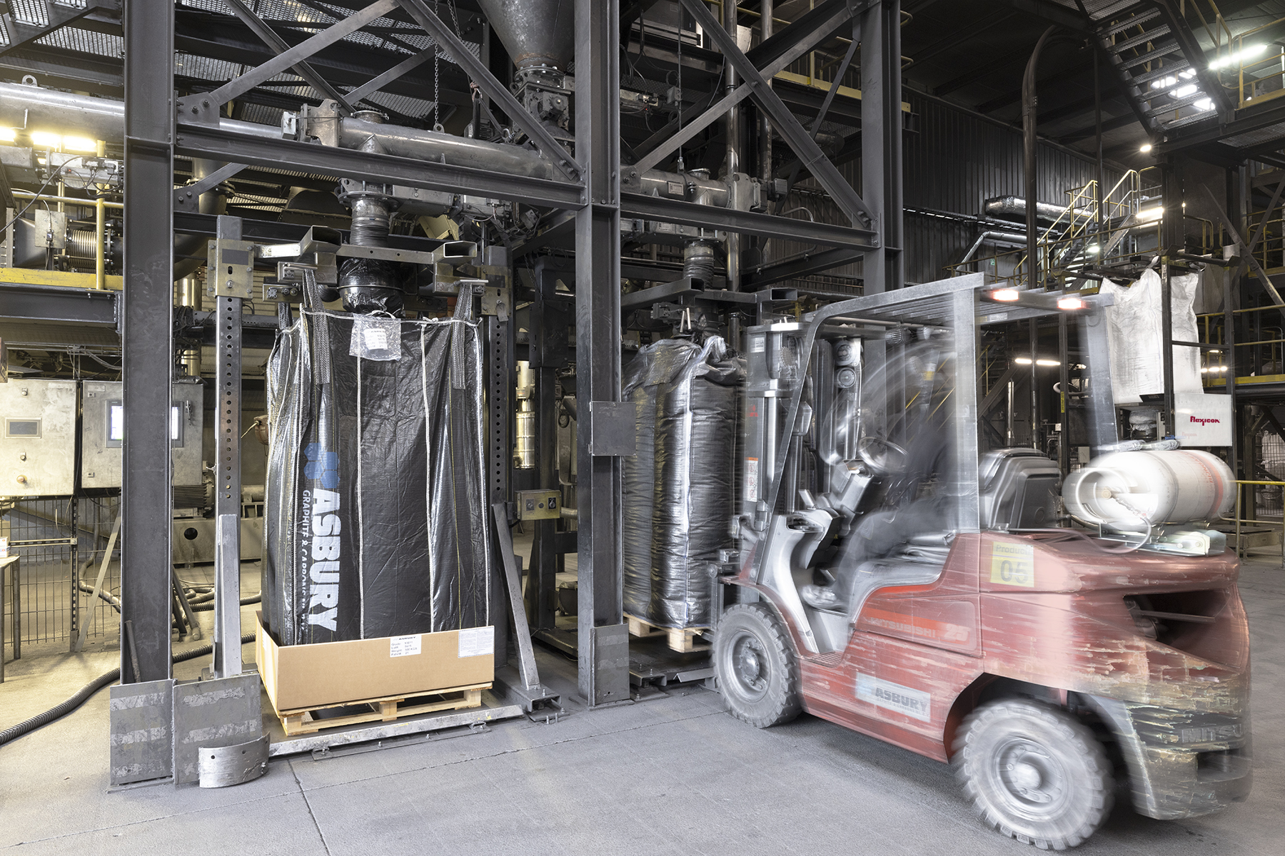

Figure 1: Pairs of forklift loaded bulk bag dischargers feed raw graphite into tubular cable and flexible screw conveyors which transport it to silos and the milling process. Courtesy: Flexicon

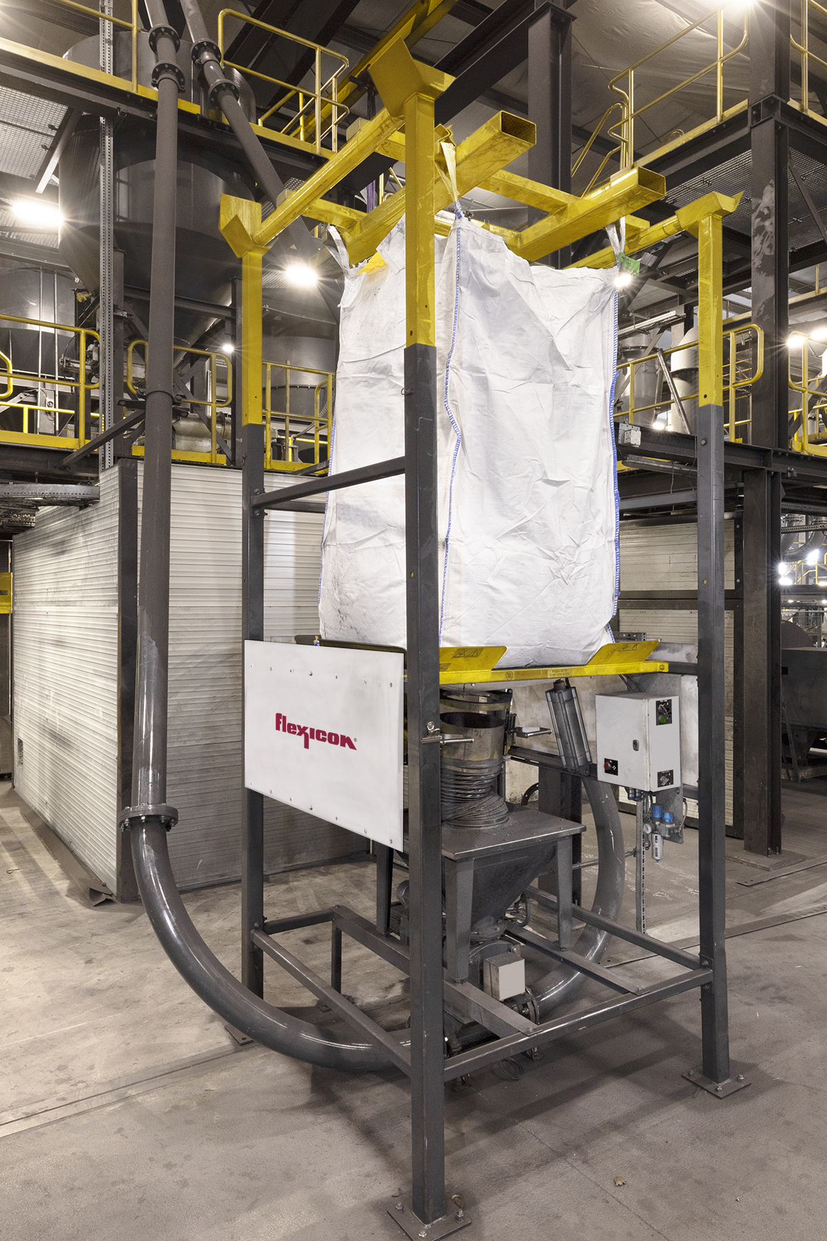

Figure 2: From hoppers beneath each bulk bag discharger, flexible screw conveyors introduce raw graphite into a tubular cable conveyor, which gently moves it to a jet mill on the mezzanine. Courtesy: Flexicon

Dust-free bulk bag discharging and conveying
The plant unloads incoming raw materials with nine bulk bag dischargers, designed to eliminate dust during discharging, collapse and removal of empty bulk bags, increasing plant safety.
Bulk bags of incoming material are loaded by forklift into the discharger frames. Operators create a dust-free bag/hopper interface by connecting the bag spout to the clamp ring which sits atop the telescoping tube. During discharge, the telescoping tube lowers the clamp ring as the bag empties, applying continual downward tension to keep the spout taut.

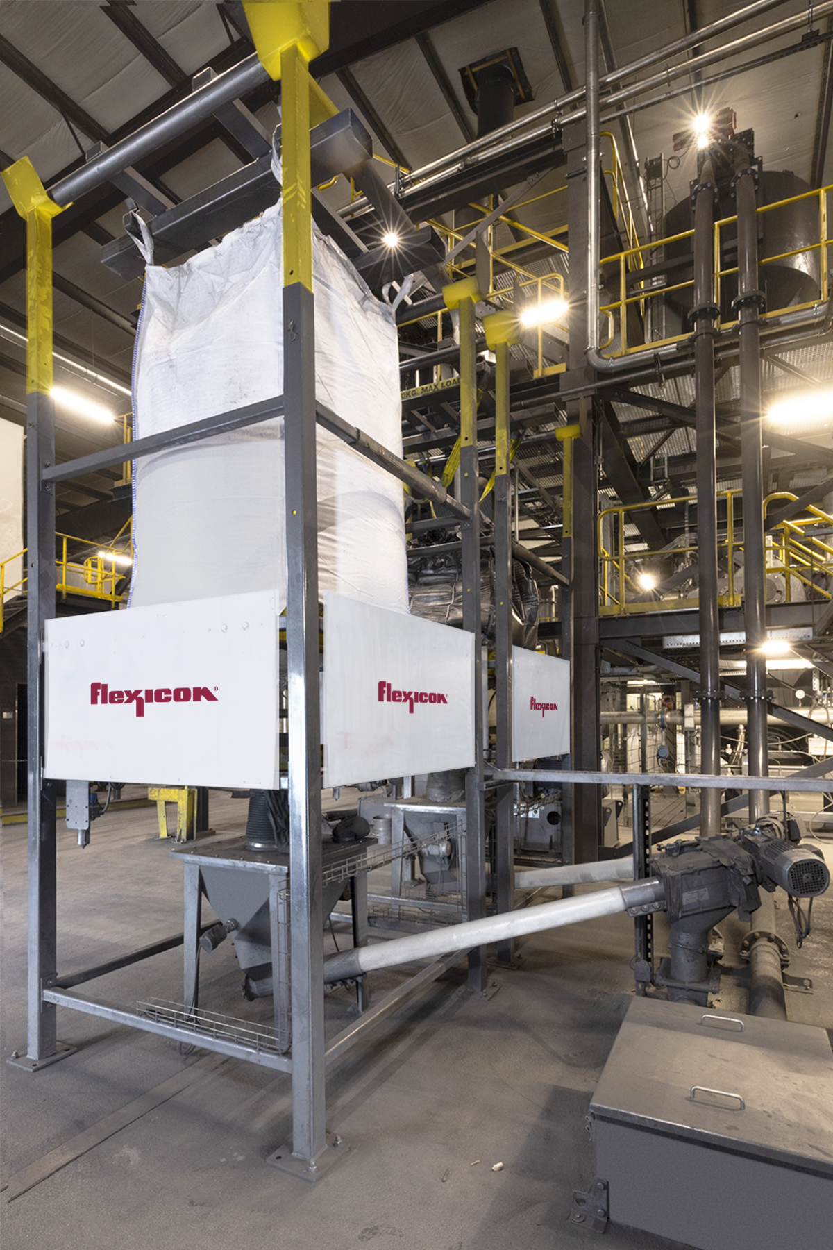

Figure 3: A rotary valve beneath each hopper feeds graphite to a tubular cable conveyor, which gently moves it dust-free to a jet mill for fine grinding. Courtesy: Flexicon

Promoting evacuation, extension arms on the dischargers’ upper frames automatically raise the bulk bag into a steep V shape. Bulk bag activator plates raise and lower the opposite bottom edges of the bag, directing material toward the bag outlet spout.
“In the past,” Stassen said, “we hung the bag from a frame and let the material gravity fall. The bag would look empty but still had 44 or 66 lb. inside and, when we removed the bag, the material ended up on the floor. Now no material remains.”

From the 5-cu ft floor hopper below each bulk bag discharger, a fully-enclosed flexible screw conveyor ranging in length between 26 to 52 ft moves the material to several silos.
The conveyors specified are designed to propel difficult-to-move materials that tend to pack, cake, smear, plug or fluidize — or break and slip in the case of graphite — without crushing or grinding material against the tube wall.
Feeding the jet mill line, a tubular cable conveyor moves graphite and coke powder from a dedicated bulk bag discharger. The fine particles exiting the bag flow into a rotary valve that meters them into the conveyor, which consists of ultra-high molecular weight polyethylene conveying discs attached to a steel cable and enclosed inside a polymer tube.

The convey line is a continuous circuit, kept under tension by a wheel near the inlet end and driven by another wheel at the discharge end.  The material rides gently in the spaces between the discs. The convey line makes a 90° turn past the inlet and moves vertically to 30 ft (9 m) in height before turning 90° again to the discharge point above the feed hopper and downspouting to the jet mill. The gentle movement reduces risk of abrasion and the enclosed circuit ensures dust-free operation.
