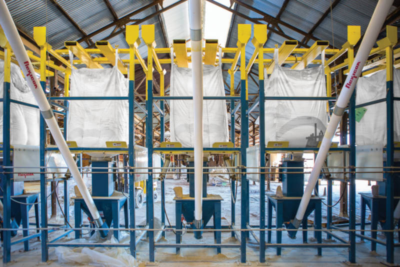

To streamline batching and mixing of clay blends for different products, the company installed five bulk bag dischargers and five pairs of flexible screw conveyors from Flexicon to automatically deliver weighments of bulk ingredients for blending of clay compounds. The system cut dispensing and weighing time for each batch by half and reduced out-of-spec material and scrap by 95%.
Figure 1: Five bulk bag dischargers and five pairs of flexible screw conveyors automatically batch clays and grogs (recycled ceramic material) into the mixer. Courtesy: Flexicon Corp.

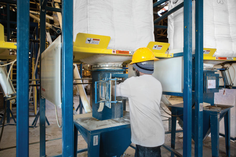

Five, forklift-loaded Bulk-Out BFF model bulk bag dischargers stand side by side. An operator attaches a bulk bag to the steel lifting frame by sliding the bag straps into four Z-Clip strap holders. A forklift raises the lifting frame with the 2,000 lb (909 kg) bag of clay or grog intact into four self-centering cradles atop the discharger frame.
With the bag in place, the operator opens a 12 inch (305 mm) diameter iris valve, pulls the bag spout through it, and closes the valve before unty­ing the spout. The operator can then open the iris valve gradually to prevent bursts of material into the hopper, and displaced dust from escaping the enclosed system.
Flow-Flexer massaging devices on each discharger promote flow by raising and lowering opposite edges of the bag at timed intervals. To impart additional flow promotion, each floor hopper is equipped with a pneumatic turbine vibrator.

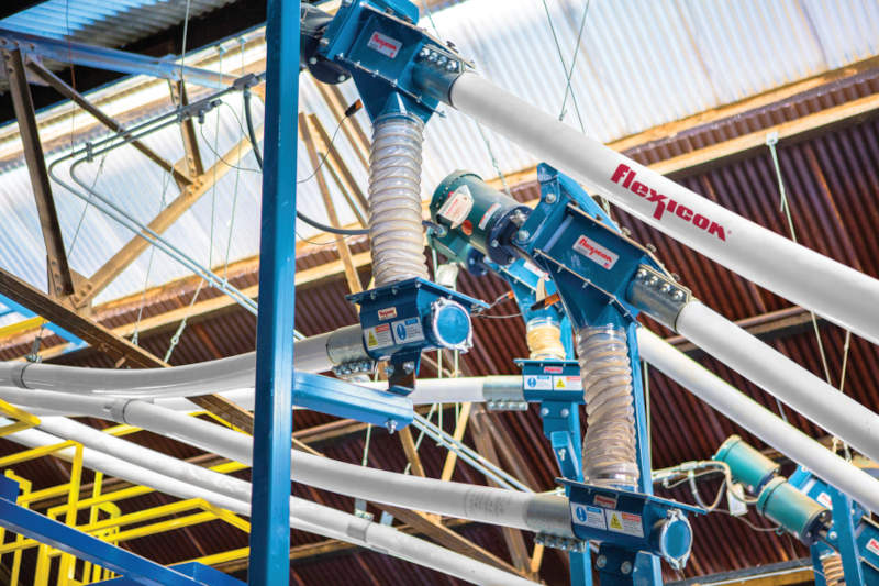

The clay or grog is transferred to the 40 cu ft (1,133 l) capacity central weigh hopper by flexible screw con­veyors in two stages to accommodate the plant’s lim­ited floor area and headroom. Each conveyor extends either 15 or 20 ft (4.6 or 6.1 m), depending on the position of the discharger and the need to route the conveyors under the roof trusses or between the truss components.
Each conveyor consists of a polymer tube with an inner flexible screw, which is driven above the dis­charge point, avoiding material contact with seals.
Figure 4: The five topmost flexible screw conveyors empty material into the central weigh hopper above the mixer. Each transition discharge adapter is situated below the drive, avoiding material contact with seals. Courtesy Flexicon Corp.
Material moves through the transition discharge adapter of the lower conveyor into the inlet of the upper conveyor. Custom-engineered masts support the top end of the first conveyor and the bottom end of the upper conveyor.
The upper conveyor gravity discharges into the weigh hopper, which is 4 ft (1.2 m) in diameter and suspended 19 ft (5.7 m) above the floor.
