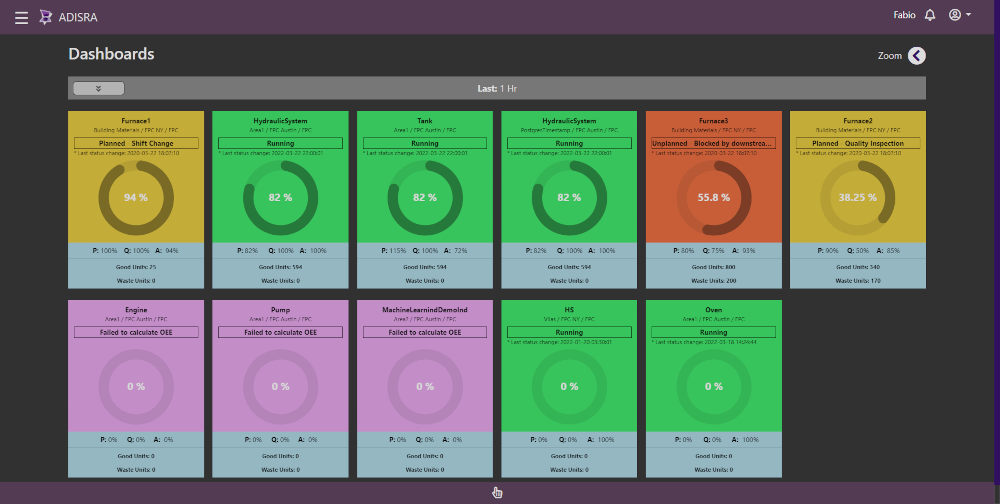

Some metrics and tools have been developed for using this real-time production data to help optimize manufacturing efficiency. Overall equipment effectiveness (OEE) monitors production results against production goals while predictive analytics detect impending equipment failures.

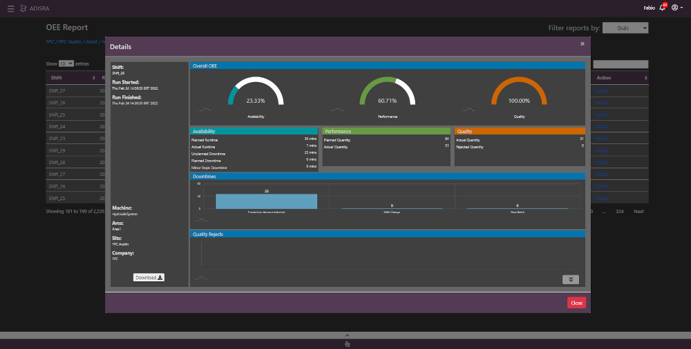

OEE is a tool used to monitor current manufacturing operations compared to its full potential. An OEE of 100% means only good parts are made at full operational speed with no production line stoppage. OEE is used as a metric for manufacturing productivity, calculated as follows:
OEE = A * P * Q
Where A equals the % of time the equipment or production line is running; P equals the % of speed/throughput performance; and Q defines the % for quality of the parts produced (Figures 1 and 2).
Figure 1: Adisra SmartView and InsightView put data acquisition into action, allowing users to easily create informative OEE displays and dashboards. Courtesy: Adisra
Figure 2: OEE reports are essential tools to help operators understand and improve manufacturing performance. Courtesy: Adisra

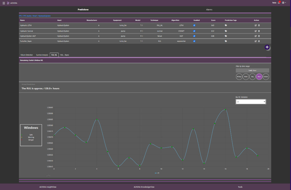

Figure 3: By analyzing past data, AdisraInsightView seeks to predict the near future of operations, and can detect the remaining useful lifetime of assets. Courtesy: Adisra
