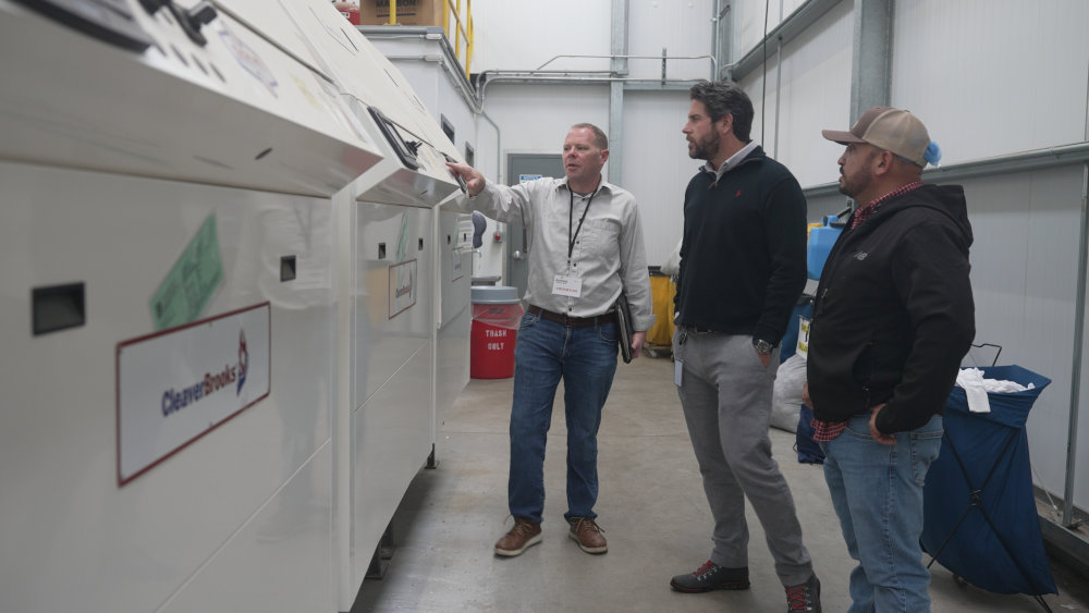

Bradey Day, program manager of TRC Companies, said installing the boilers for Ostrom was a new kind of challenge for them and Cascade, which was contracted to do the installation. They used three ClearFire ultra-high efficiency/low emissions duel fuel natural gas and propane firing condensing hot water boilers from Cleaver-Brooks for the project. They are 96% efficiency a design pressure of 125 PSIG, which allows them to operate in tough conditions.

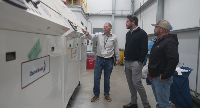

Ostrom had three high-efficiency condensing boiler systems installed in their Sunnyside, Wash., facility, which were designed to help them reduce overall energy costs. Images courtesy: TRC Companies/Cascade Natural Gas Corporation

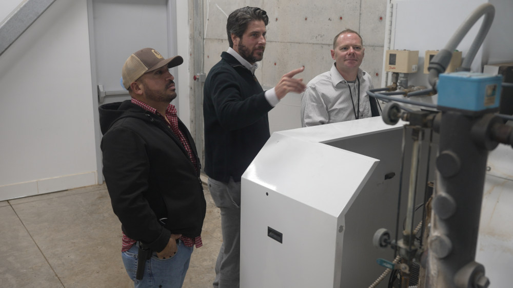

Ostrom had three high-efficiency condensing boiler systems installed in their Sunnyside, Wash., facility, which were designed to help them reduce overall energy costs. Courtesy: TRC Companies/Cascade Natural Gas Corporation
