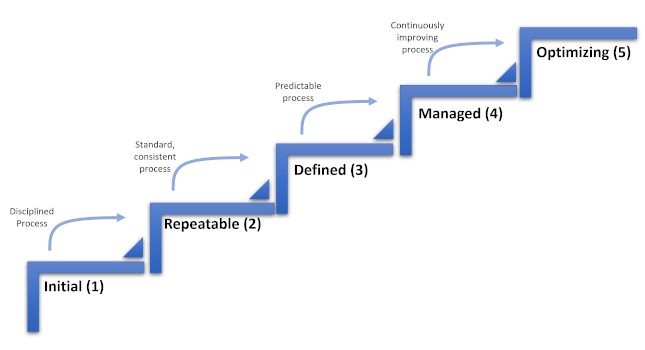

The Capability Maturity Model (CMM) describes a series of increasing capabilities that can be measured (see Figure 1). Translate this to the engineering information management world and take the example of assigning new equipment numbers for a project executed in the facility.
For example, a process at the initial level would describe that the organization is not even aware of the need for a process (see Figure 1). The result of this is that equipment numbers are assigned at free will by either an engineering, procurement and construction (EPC) contractor or the engineer that might be working on the project. As a result, there is a duplication of numbers, no consistency and no alignment between the different systems that use this information. The result of this is it becomes difficult to find information or establish if the information is accurate. People do not trust the information and often do a field check to make sure what they have is accurate.
Consider the opposite scenario, a process description at the optimizing level would, for example, describe a software solution controls the assignment of equipment numbers, there is a procedure that describes this, and the system is aligned with industry standards and there is a yearly review on the quality of the information (see Figure 2).
