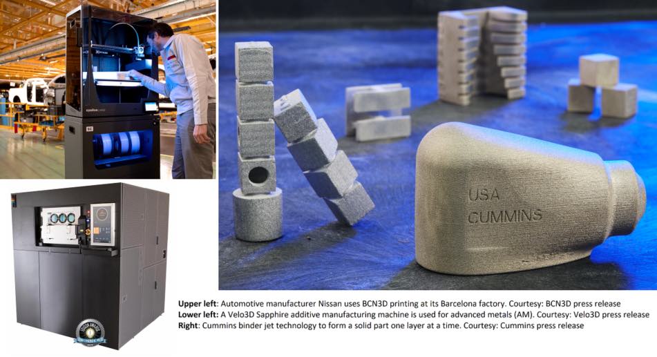

Nissan accelerates assembly, lowers costs with 3D printing
Automotive manufacturer Nissan integrated 3D printing into its production process at the Nissan Barcelona factory using BCN3D, a Spanish 3D printing solutions manufacturer. By printing some parts in-house with 3D printers, Nissan has cut the time of designing, refining and producing parts from one week to one day and slashed costs by 95%. Nissan is printing 3D materials in plastic and is trialing metal, according to BCN3D.
Nissan created 700 3D printed parts as of June, some costing as little as 3.45€ to manufacture.
Carlos Rellán Martínez, manager of maintenance and engineering facilities at Nissan Motor Ibérica Zona Franca, Barcelona, said: “Outsourcing tools to a mechanical supplier was 20 times more expensive than 3D printing the same parts. The wait for tools went from a week down to one day…. We have paid off the investment in the printers very quickly.”
Cummins integrates metal 3D printed production
Cummins Inc. announced in May it is finalizing its first production part using a new, high-precision 3D metal printing technology called binder jet, a “significant milestone in the company’s additive manufacturing and Industry 4.0 journey.”
Additive manufacturing of the lance tip adapter, a critical emissions component in Cummins engines, provides a lighter-weight design, improved geometry for fluid and air flow, and eliminates cross-drilling complexity.
Tim Millwood, vice president of global manufacturing at Cummins, said, “We’re on the cusp of being able to leverage a broad range of additive technologies to print the parts we need, using the right technology and at lower costs and increased speeds.” Cummins and GE Additive are developing third-generation binder jet technology, for higher throughput, improved quality and lower cost.
Additive manufacturing without a 3D printer
Contract manufacturers Addman Engineering and Wagner Machine Co. are offering 3D manufacturing services with high-value metal parts, without purchasing a 3D metal printer than can cost well over $1 million. Advanced motion controls, real-time sensing and monitoring, and quality assurance add value to machines.
Velo3D, maker of additive manufacturing machines, cited Wagner Machine CEO Kurt Wagner as saying, “We recently had a customer ask us to make a brazed assembly that was impossible due to space constraints and other requirements. We suggested 3D printing, which was their original plan, but other 3D printing companies they consulted said the part would be impossible to print due to thin walls and pressure requirements.”
Mark Saberton, Addman CTO and founder, said, “The full-stack laser powder bed fusion 3D printing solution from VeloELO3D gives our customers the freedom they need to design the next generation of spacecraft and turbomachinery without compromising their designs for the sake of manufacturability.”
