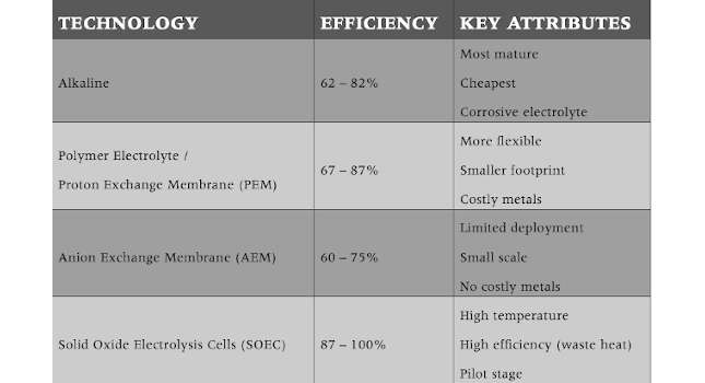

Electrolysis works by connecting a dc electrical power source to two electrodes placed in an electrolyte solution. This causes hydrogen to appear at the cathode and oxygen at the anode. Electrolysis technologies include alkaline, polymer electrolyte/proton exchange membrane (PEM), anion exchange membrane and solid oxide electrolysis cells (SOEC) (see Table 1) (see Sidebar “UCI and SoCalGas to lead DOE green steel effort”).
