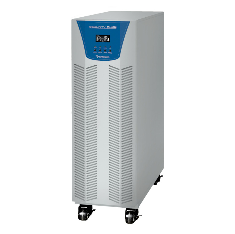

Today’s uninterruptible power supplies feature low impedance isolation transformation technology and increased load inrush capacity.
Today’s uninterruptible power supplies feature low impedance isolation transformation technology and increased load inrush capacity. Courtesy: AMETEK Powervar
