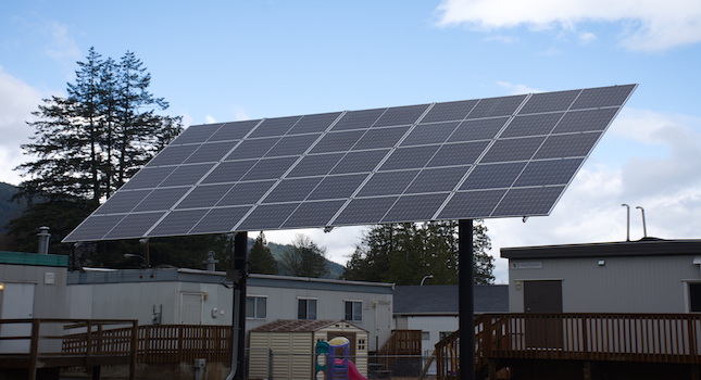

When a school district is located on mountainous terrain, extreme winds can create situations where blackout events happen. This was a glaring issue for a rural school that faced multiple power outages resulting in a complete evacuation of the students. In conjunction with the local utility, a plan was established to install a renewable energy system with solar and batteries to manage such unforeseen events as a battery charging solution. This included a collaboratively developed demand response program with the utility, peak shaving, and a back-up power solution.
The fast payback was attractive to the school while having the opportunity to improve its power quality. Although, the project was not as straightforward as originally proposed.

An example is installing solar panels on the rooftop of a healthcare facility or school building. A large rooftop can manage up to 0.5 MW of solar panels. Similarly, a battery system covering an area of 30 meters2 (325 sq ft) can support up to 4.0 MWh of storage.
