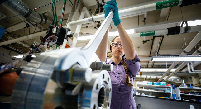

The U-M team conducted the first chemical analysis of how siloxanes affect biogas. The researcher found that siloxanes increase the reactivity of biogas, leading to faster ignition in engines and the release of more energy. But those engines—typically power-generating gas turbines and reciprocating piston engines—can be damaged by the siloxanes in the biogas.
“Siloxanes are highly ignitable,” said Margaret Wooldridge, Arthur F. Thurnau Professor of Mechanical Engineering and Director of the Dow Sustainability Fellows Program at the University of Michigan. “They change the chemistry of biogas like crazy. The stuff is like rocket fuel, literally—crazy-reactive.”
The siloxanes essentially change the biogas’s “flame speed,” which is a measure of how quickly a fuel combusts and drives a turbine or piston.

In this study, U-M researchers separately tested hydrogen and carbon monoxide mixtures containing two siloxanes—trimethylsilanol (TMSO) and hexamethyldisiloxane (HMDSO)—against hydrogen and carbon monoxide mixtures with no siloxanes. Specifically, the researchers clocked how long it took for each mixture to ignite. Fuels that have a shorter ignition delay are considered more ignitable or reactive—and hydrogen is one of the most reactive fuels we use.
Hydrogen and carbon monoxide with TMSO produced ignition delay times that were 37% faster than the reference case. And HMDSO-infused methane produced delay times 50% faster.

“Trace concentrations of siloxanes have been a known problem in biogas applications—leading to the formation of abrasive silica deposits on engine components,” said Rachel Schwind, a doctoral candidate. “For this reason, most prior research in this area has focused on how to remove them from the captured gas.”
