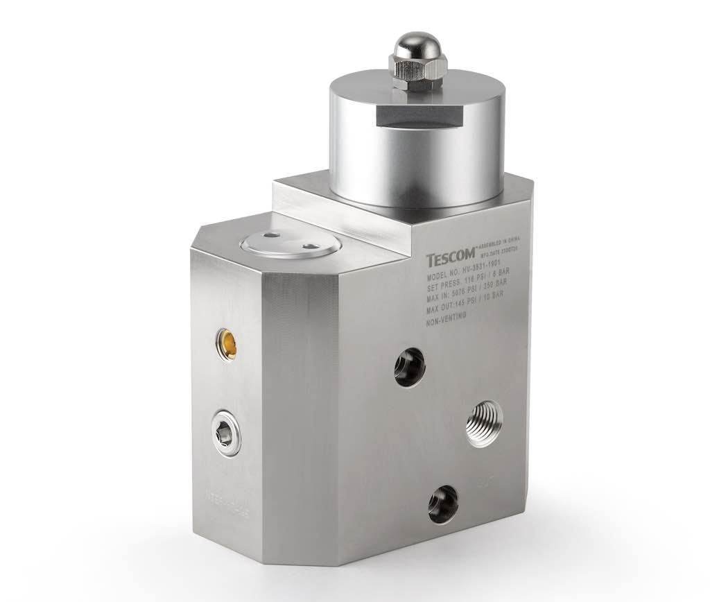

Figure 2: The TESCOM HV-3500 Series Hydrogen Onboard Regulator provides consistent pressure and continuous flow, maximizing fuel cell efficiency in industrial and commercial light and heavy-duty hydrogen fuel cell vehicles. Courtesy: Emerson
