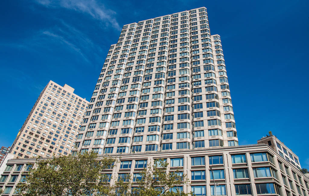

From the customer’s viewpoint, Johnson said it was important the project’s installation have a small footprint, which serves as a nice parallel to the company’s goal.
“It’s hard to reduce on-site emissions,” Johnson said. “For us, we’re relying on the overall infrastructure. We take pride in not being very disruptive to their operations. We can locate systems in garages, on rooftops and setbacks or wherever space is available in or adjacent of the building.”
Johnson described a 377,000-sq-ft multi-family building in Manhattan and how their Building Carbon Capture System takes up only 600 sq ft, which is a drop in the bucket by comparison. The goal for the multi-family project, Johnson said, is to reduce emissions by 25% so the owners wouldn’t be hit by the carbon taxes and provide a 5-year return on investment (ROI).
“We’re trying to make a scalable platform that links into the building,” Johnson said. Not only is minimizing the system size critical to being able to apply the technology, but modularity and flexibility of the design is also crucial as it allows us to place our standardized modules very flexibly within available building space.  We offer a range of product sizes that allows us to cover the broad set of building sizes and meet a wide range of carbon reduction goals.”
The system itself, in addition to being small, is also designed to be smart. “We couple our Building Carbon Capture System hardware with intelligent software to continuously optimize the system operations,” Johnson said. “The carbon capture control system makes all the hardware pieces interact as efficiently and effectively as possible to get the best results. Each building receives a Carbon Gateway that interfaces between the site system and our cloud Carbon Management System™ which measures and reports each building and the customer’s combined building portfolio carbon performance over the life of the system operations.
The multi-family unit in Manhattan is one of more than 50,000 buildings in New York City that are subject to LL97 and need to reduce their CO2 emissions. More than 80% are multi-family with commercial, hotels and manufacturing making up the rest of the pie.
For many of these facilities, Johnson said it’s about doing something now. “Why wait for a 100% green grid when we can dramatically reduce emissions now? 95% of the buildings that exist today will be standing 50 years from now. When these buildings and the surrounding utility infrastructure were built from ground up to use natural gas, it’s very challenging and costly to convert them to electricity. These buildings need an alternative to decarbonize now. And we’re seeing a significant interest our approach.”
Figure 2: CarbonQuest installed their CCUS in a 377,000-sq-ft multi-family unit in Manhattan with a goal to reduce CO2 emissions by 25% and provide a 5-year return on investment (ROI). Courtesy: CarbonQuest
