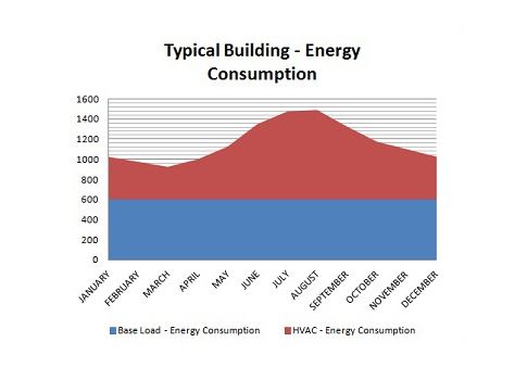

For commercial buildings, the internal load is constant and calculated using a simple means of BTUs/hour as produced by equipment, lighting, and people. Of course when calculating the actual tonnage requirement for the entire building, all the other factors come into play regarding the building characteristics as well as weather. The load that remains unaffected by weather or external condition is referred to as the “base load” of the building. It’s safe to say, this base load occurs monthly.
The graph in Figure 1 shows the base load and how the heating and air conditioning adds to the total energy consumption of that building:
HVAC can account for as much as 50% of the total energy consumption of commercial buildings. As we all know, the outside air temperature affects the level of comfort in the building and therefore the operation of the HVAC equipment. If your building has working outside air economizers on central air handling systems, you have the ability to supplement the mechanical cooling with “free” cooling when the outside air temperature is within an acceptable range.
