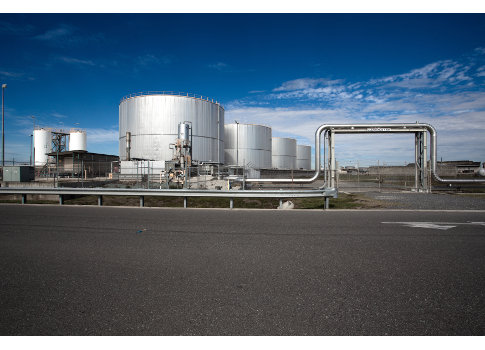

A Houston area petrochemical blending facility was experiencing numerous operational and maintenance issues with their steam-heated oil and lubricant storage tanks.
A Houston area petrochemical blending facility was experiencing numerous operational and maintenance issues with their steam-heated oil and lubricant storage tanks. Improperly sized and designed system components, as well as incorrect piping layouts, were leading to the facility not being able to maintain tank setpoint temperatures, thereby increasing system maintenance requirements. Spirax Sarco was able to assist them in standardizing system designs, which allowed for reliable, consistent, operational temperatures and minimal downtime.
At ambient temperatures, heavy oils and lubricants cannot be pumped due to high viscosity. Steam-heated storage tanks are used in order to reduce the viscosities of stored viscous fluids so that they can be pumped as needed. Due to the irregular demand on those products, the heat needs to be supplied continuously to the tanks so that there is constant availability. When product temperatures vary below setpoint, pumping the product can become difficult. When product temperatures vary above setpoint, the product can be damaged requiring disposal. Both outcomes can prove costly.
