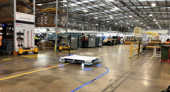

Autonomous mobile robots (AMRs) are smart devices that can move through an environment without requiring the assistance of a human operator. The environment, in this case, is the warehouse layout. AMRs are expected to navigate the floor without having to rely on a fixed pre-determined path or magnetic tracks.
AMRs rely on advanced technologies to navigate the shop floor. These technologies include sensors to track its immediate environment and understand it, loading and unloading gear to automate order pickups and other smart devices to capture data. AMRs differ from AGVs in several ways but the most important difference is their ability to navigate the shop floor without following preset tracks.
AMRs comprehensively automate the in-house logistics and material handling process within warehouse facilities using the technologies they’re equipped with. When implemented, AMRs can serve as edge devices that capture data from the warehouse and transfer the captured data to centralized computing platforms for further analysis.
The autonomy AMRs provide means they can be deployed to handle milk runs and other transportation strategies within the warehouse. AMRs can liaise with other digital transformation tools such as the digital twin to implement some Industry 4.0 business models. For example, a risk-based schedule integrates real-time changes such as new deadlines to optimize warehouse operations. AMRs can utilize the new schedule to speed up its just-in-time deliveries to meet the new delivery timeline.

Larger warehouses mean extensive storage space stocked with thousands of inventory. Navigating these complex structures increases lead time for fulfilling orders and is prone to errors as manually navigating large spaces even with a map is challenging. AMRs are equipped with the capacity to analyze data and pinpoint inventory quickly. The speed of operation AMRs bring to the table reduces the lead time for fulfilling bulk orders in large warehouses and reduces the walking times of operators within the warehouse.
2. Increased flexibility
AMRs do not need to be wired to follow set pathways. This means an AMR can find its way despite recent changes to a warehouse layout to accommodate new products. The flexibility autonomy provides means AMRs can be tasked with new activities without having to go through any complex onboarding process.
3. Increased safety
One major reason for deploying AMRs in warehouses is to reduce accidents on the shop floor caused by traffic and the use of heavy lifting equipment such as forklifts. The sensors integrated into AMRs ensure they understand their environment to adjust their speed and avoid collisions in real-time when handling material handling activities. Applying AMRs for repetitive transportation also removes humans from problematic situations which can cause harm.
4. Scalability
AMRs can be implemented using modular deployment strategies which can be scaled up to meet expanding operations. The onboarding process does not require the laying of tracks or purchasing multiple tugger carts or robotic equipment which reduces the startup cost for utilizing AMRs. Warehouse managers can simply add new AMRs to an available fleet when scaling up is required.
