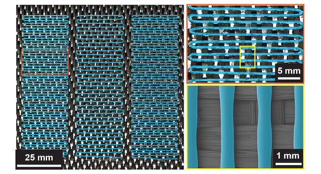

3D printed thermoplastic on woven-carbon fiber reinforcement. Courtesy: NC State University

Laminated composites are made from layers of fibrous reinforcement, e.g. glass and carbon-fiber, bonded together. Damage most often occurs when the “glue” that binds these layers together begins to peel away from the reinforcement, or delaminate. The research team addressed this problem by 3D printing a pattern of thermoplastic healing agent onto the reinforcement material. The researchers also embedded thin “heater” layers in the composite. When an electrical current is applied, the heater layers warm up. This, in turn, melts the healing agent, which flows into any cracks or microfractures within the composite and repairs them.
