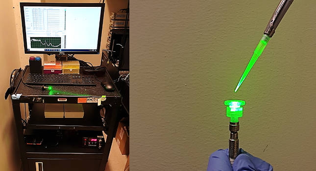

The researchers incorporated their sensor into a prototype with a fiber optic tip that can detect changes in fluorescence in the test sample. Courtesy: Massachusetts Institute of Technology

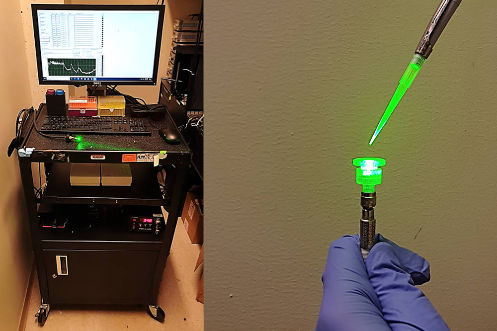

Within about 10 days of starting the project, the researchers had identified accurate sensors for both the nucleocapsid and the spike protein of the SARS-CoV-2 virus. During that time, they also were able to incorporate the sensors into a prototype device with a fiber optic tip that can detect fluorescence changes of the biofluid sample in real time. This eliminates the need to send the sample to a lab, which is required for the gold-standard PCR diagnostic test for Covid-19.
