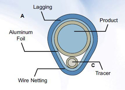

In every installation, insulation should cover both the product line and tracer, but the air space must remain clear. This can be achieved three ways (figure 3)
  • Aluminum foil or galvanized steel sheet can be wrapped around the line and tracing; then, insulation is applied over the sheet or foil. Alternatively, small mesh galvanized wire netting can be used instead of metal sheet.
  • Sectional insulation preformed to one or two sizes larger than the product main can be used. One disadvantage is this insulation can be easily crushed.
  • Preformed sectional insulation designed to cover both product line and tracer can be used. Preformed rigid sectional insulation usually is preferred to plastic material because – rigid insulation retains its thickness and efficiency.
In all cases, the insulation should be finished with waterproof covering: Most insulation is porous, and it is useless as heat-conserving material if it is allowed to absorb water. It also may need to be protected from mechanical damage.
