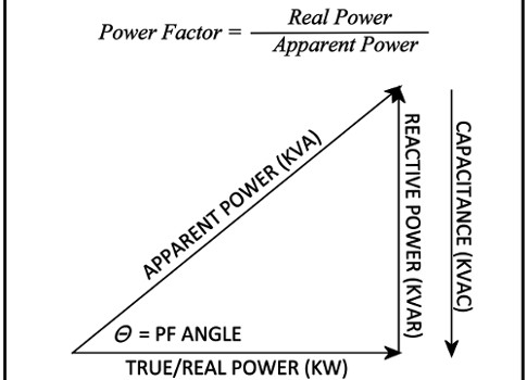

Power factor is a dimensionless number between 0 and 1 that is defined as the ratio of real power (kW) to apparent power (kVA). Real power is considered to be the work producing component. Apparent power is the product of the total current and voltage used by the load, which includes power used for electromagnetic fields. In other words, real power is the amount of power needed to perform the work in a perfect world while apparent power is the power needed to perform the work in real world conditions. This relationship is shown in figure 1. While power factor may vary over time, generally speaking, a high power factor indicates effective utilization of electrical power. A low power factor means you’re not fully utilizing the electrical power for which you are paying. A simple way to look at power factor is as a measure of how effectively electrical power is being used. A power factor of 1 (unity) is an indication of operating at a perfectly effective use of power while a 0.5 is an indication of a very inefficient use of power. A power factor of any value other than unity is caused by inductive or capacitive reactance and harmonics on the system.

The most practical and economic power factor improvement device is the capacitor. Capacitors produce capacitive reactive power, which is the opposite of inductive reactive power that is the primary driver behind low power factor values. The inductive reactive power causes the current peak to occur after the voltage peak (lagging), where the capacitive reactive power causes the current peak to occur before the voltage peak (leading). By careful selection of capacitance to add to a low power factor system, it is possible to totally cancel out the inductive reactive power. There are two methods for improving power factor using capacitors: individual load compensation and centralized compensation.
