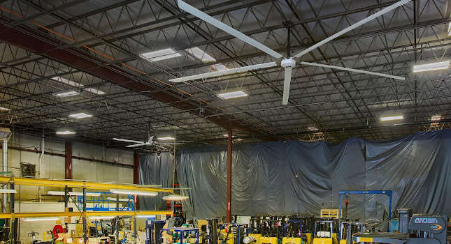

High-volume, low-speed (HVLS) fans are large industrial ceiling fans used in plants, facilities, manufacturing centers, distribution centers and other large buildings (see Figure 1). Designed with longer blade lengths than conventional fans, HVLS fans have diameters ranging from five to 24 feet (see Figure 2). The fans move large volumes of air with minimized energy consumption per square foot.
