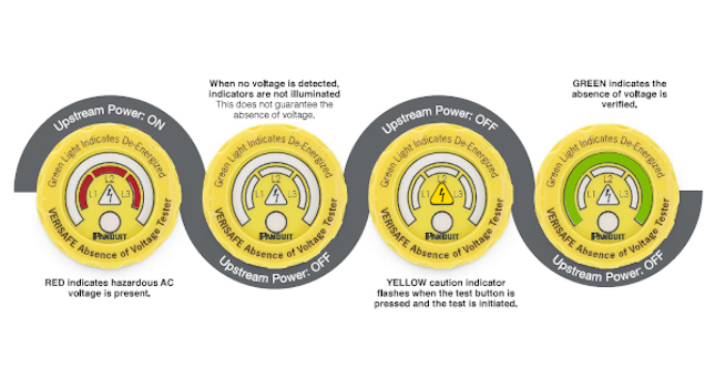

Actual absence of voltage testers
An absence of voltage tester (AVT) is specifically designed to prove absence of voltage, without requiring a qualified person to open equipment doors and potentially expose themselves to electrical hazards (see Figure 1). AVTs allow a person to push a button that starts a test sequence that meets all the requirements for verifying the absence of voltage. The AVT automatically self-tests with a known voltage source and checks for direct contact with the circuit at time of testing (see Figure 2). It then tests for absence of ac and dc voltage — phase-to-ground and phase-to-phase.
The push-to-test capability of AVTs allows a facility to build in efficiency, and unlike manual testing, is performed without exposure to electrical hazards. Ensuring the efficient process is also safe is the purpose of UL 1436, which is beyond the scope of this article to fully describe, but it includes a number of fail-safes and extensive reliability functions.
