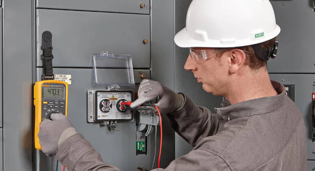

Figure 1: A qualified electrician taking a voltage reading using a voltage test station permanent electrical safety device and his portable test instrument. Courtesy: Grace Technologies

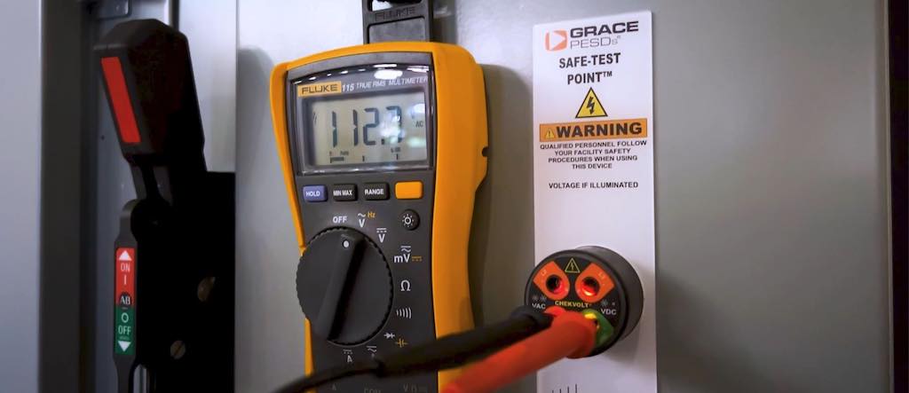

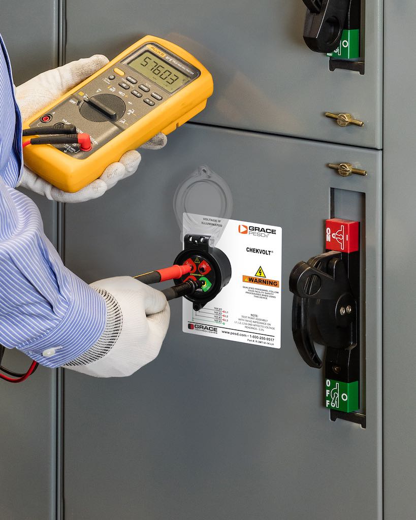

Figure 2: A portable test instrument with meter probes inserted into a ChekVolt permanent electrical safety device's high impedance protected test points. Courtesy: Grace Technologies

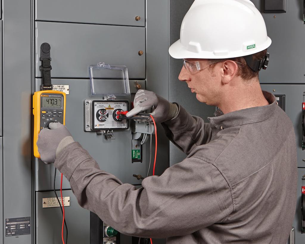

Figure 3: A qualified electrician taking a voltage reading using a safe test point permanent electrical safety device and his portable test instrument. Courtesy: Grace Technologies
