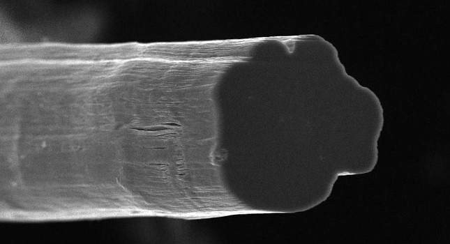

Carbon nanotube fibers made at Rice University are now stronger than Kevlar and are inching up on the conductivity of copper.
The Rice lab of chemical and biomolecular engineerĀ Matteo Pasquali has developed its strongest and most conductive fibers yet, made of long carbon nanotubes through a wet spinning process.

The flexible Rice fibers have a tensile strength of 4.2Ā gigapascalsĀ (GPa), compared to 3.6 GPa for Kevlar fibers. The fibers require long nanotubes with high crystallinity; that is, regular arrays of carbon-atom rings with few defects. The acidic solution used in the Rice process also helps reduce impurities that can interfere with fiber strength and enhances the nanotubes’ metallic properties through residual doping, Dewey said.
ā€œThe length, orĀ aspect ratio, of the nanotubes is the defining characteristic that drives the properties in our fibers,ā€ he said, noting the surface area of the 12-micrometer nanotubes used in Rice fiber facilitates betterĀ van der WaalsĀ bonds. ā€œIt also helps that the collaborators who grow our nanotubes optimize for solution processing by controlling the number of metallic impurities from the catalyst and what we call amorphous carbon impurities.ā€
The researchers said the fibers’ conductivity has improved to 10.9 megasiemens (millionĀ siemens) per meter. ā€œThis is the first time a carbon nanotube fiber has passed the 10 megasiemens threshold, so we’ve achieved a new order of magnitude for nanotube fibers,ā€ Dewey said. Normalized for weight, he said the Rice fibers achieve about 80% of the conductivity of copper.
