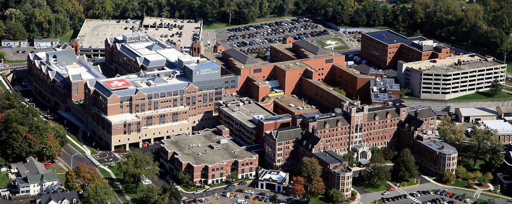

A combined cooling heat and power (CCHP) system was installed at the Baystate Medical Center in Springfield, Mass. Courtesy: Baystate Medical Center/BROAD USA

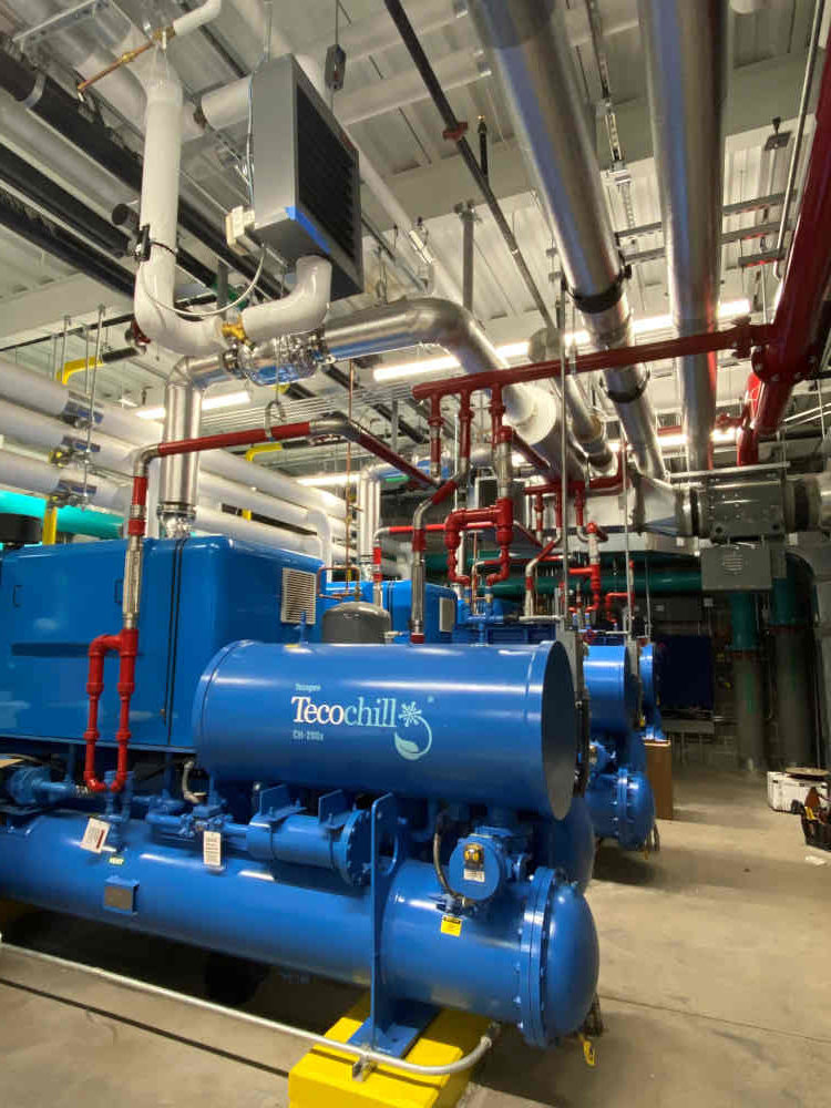

Tecogen installed a mechanical CHP that uses natural gas rather than electricity to provide constant cooling for the Skating Club of Boston’s new facility in Brighton, Mass. Courtesy: Tecogen
