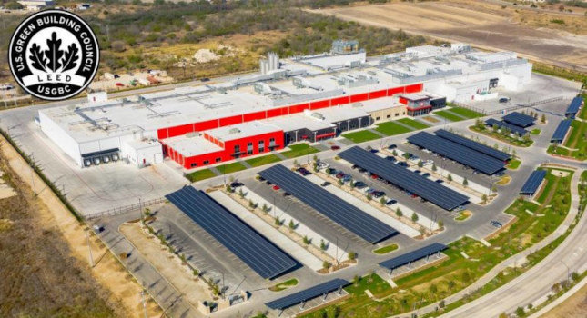

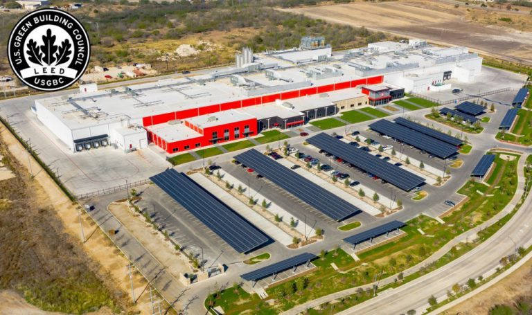

Stellar’s recent design-build project for Cuisine Solutions was named Food Engineering magazine’s 2021 Sustainable Plant of the Year. The LEED-registered facility in San Antonio, Texas, is the largest sous vide processing plant in the world with nearly $200 million in investment and measuring 315,000 square feet.
Cuisine Solutions, LEED-registered facility in San Antonio, Texas.
Cuisine Solutions, LEED-registered facility in San Antonio, Texas. Courtesy: Stellar

The Cuisine Solutions facility is the largest participant in San Antonio’s Big Sun Community Solar program. The plant’s 300-space parking area is shaded by solar panels that are available for purchase by San Antonio area residents. The clean, renewable energy generated by the solar panels (up to 894 kWDC) is sent to the local utility’s energy grid, and the savings are credited to the solar panel owner’s home electric bill.
Not only does this massive installation provide covered and convenient parking for the facility’s employees, it takes advantage of a renewable resource to lighten the burden on the community’s energy use.
Plus, it’s a win-win: It gives new purpose to an otherwise single-use parking lot while providing solar energy access to local apartment residents and others who can’t locate a solar panel on their property.
Massive solar panels shade the facility’s 300-space parking lot while providing renewable energy to the surrounding San Antonio community.
Massive solar panels shade the facility’s 300-space parking lot while providing renewable energy to the surrounding San Antonio community. Courtesy: Stellar

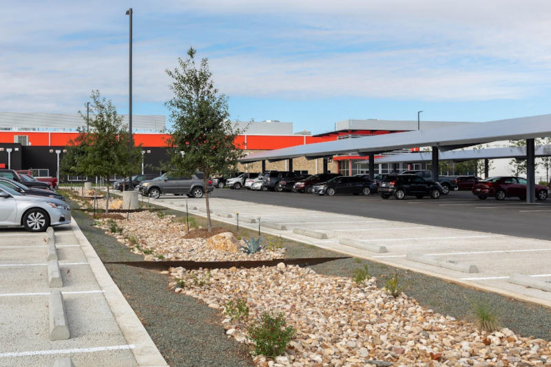

Another one of the sustainability features at the LEED-registered facility is its management of storm water runoff by leveraging low-impact development principles. Bioswales located around the structure and below the parking area concentrate and convey storm water runoff while filtering out debris, pollution and silt.
Pervious concrete used for parking spaces allows rainwater to permeate through the surface into sand and stone below, which act as a filter. A system of perforated piping runs beneath to collect the filtered rainwater and send it to the nearby San Antonio River (just a few miles to the west) cleaner than it would have been otherwise.
Civil and landscape engineers designed the system, and the Stellar team constructed it in the field. The bioswale runs four feet below the ground at its deepest point and includes a vapor barrier to prevent excess water from leaking into the soil below. The water’s velocity is also greatly reduced when leaving the site, which helps prevent erosion. This particular low-impact design is the first of its kind in the city of San Antonio.
The bioswales on the Cuisine Solutions campus incorporate locally sourced materials and landscaping native to the region.
The bioswales on the Cuisine Solutions campus incorporate locally sourced materials and landscaping native to the region. Courtesy: Stellar
