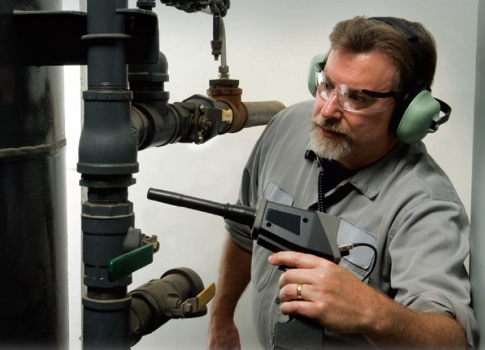

Conduct a compressed air leak assessment
Most facilities rely on maintenance crews to repair leaks that are loud enough to be heard and identified. This can be challenging when normal operating noises drown out the hissing sound. Some maintenance workers walk the facility during plant-wide shutdowns to check for leaks, but this can be misleading. Many compressed air consumers are isolated from the system when they are turned off.
Your routine maintenance schedule should include a compressed air leak assessment conducted by a professionally trained team. They can use ultrasonic technology to identify and quantify even very small leaks in loud environments.
The majority of compressed air systems leak up to 30%, which can run up large energy bills. A leak assessment can help you identify the cause, location, and size of the leak, and determine the best course of action to correct it. The solution may be as simple as tightening your pipe fittings, but these system improvements can add up to significant energy savings over time.
“We have done significant research on how customers address system leaks, and we discovered that companies that try to deal with leaks on their own typically have the largest amount of problems,” said Jennifer Eckert, marketing manager, Americas service solutions at Ingersoll Rand. “This makes sense when you consider that most maintenance crews are in high demand and short on time. They have to prioritize issues related to the production process and unique system equipment, and mitigating leaks falls lower on the to-do list.”
Another challenge lies in the complexity of the ultrasonic leak detection equipment. Professional audit teams have years of experience and a refined inspection process that help increase the efficiency and effectiveness of the tool. Knowing how to use the ultrasonic device is only half the battle. It is difficult to inspect the entire system if you need to stop and fix each leak along the way. Consequently, the air leak assessment becomes an exercise in finding leaks, recording their location, and fixing them at a later date. It is important to quantify the volume of the leaks and compare that data to industrial class references. Otherwise, you may not repair enough leaks to significantly improve the efficiency of your system.
Finally, companies that try to manage compressed air system leaks on their own struggle with trending and root cause analysis.
“Maintenance workers correct the leaks, but treat it like an event without reporting the issue or analyzing the cause,” Eckert said. “It is critical that companies inventory their system leaks based on type, location, and volume. This process should be repeated at least once a year to identify reoccurring issues and ensure leaks are repaired once, the right way.”
