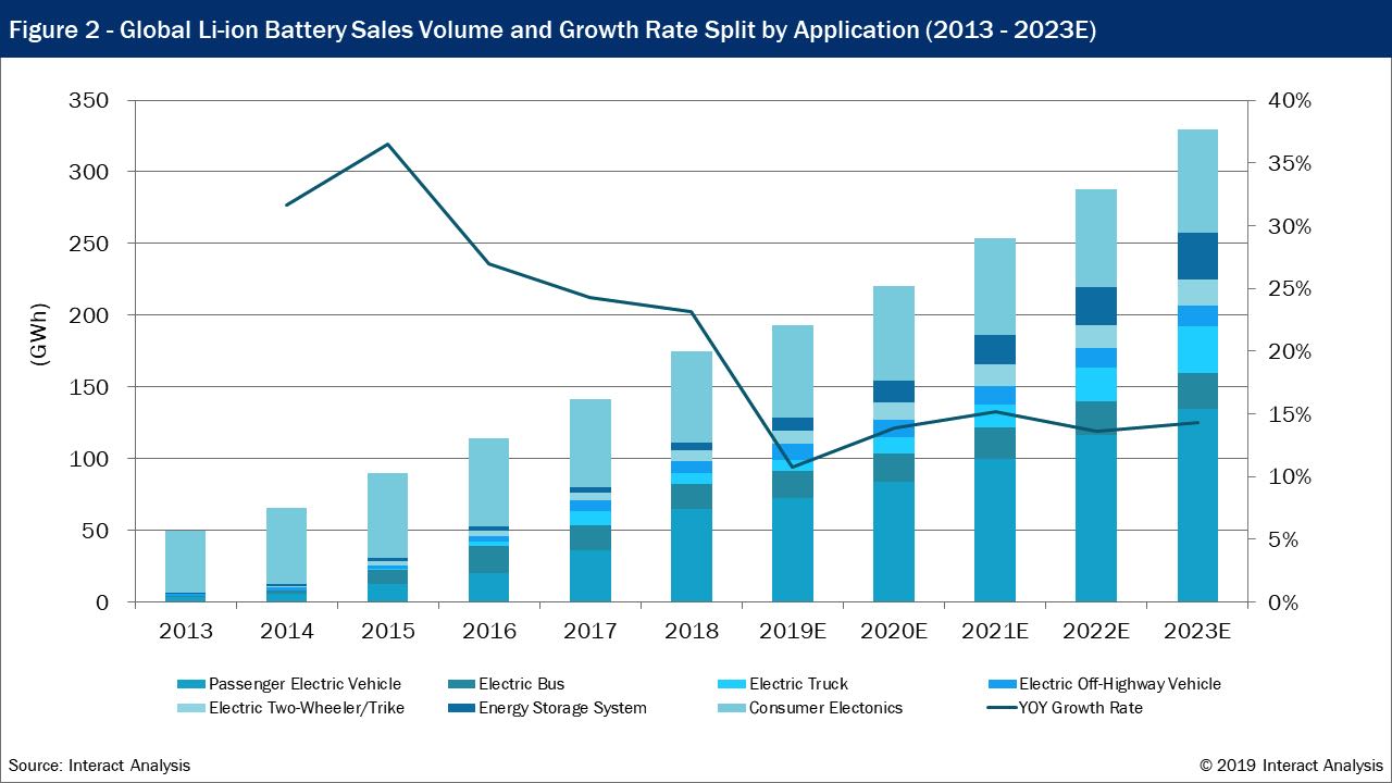

From a demand perspective, in 2018, global lithium-ion battery sales reported year-on-year growth of 23.1% – to 174.5 GWh (Figure 2). The energy storage market is predicted radical growth with a CAGR of 40.4% over the next five years – driven by renewable energy. Transport is expected to account for 68.4% of battery sales in 2023 to become the main demand-side market driver – having first exceeded the consumer sector’s share of the market back in 2017. Saturation of demand for lithium-ion batteries in consumer applications, and a failure to establish an advantage in transport, accounts for a predicted fall in the battery sales market share of Japan and South Korea. In spite of this, however, the lithium-ion battery market remains concentrated in Asia for the short term – with the region accounting for 72.6% in 2018, of which China contributed nearly half.
