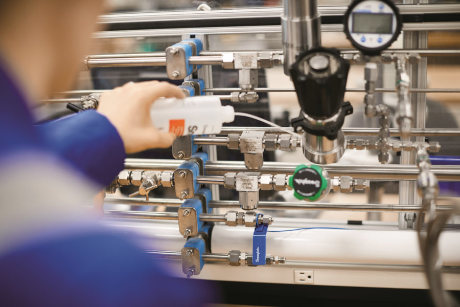

If gas bottles are used inefficiently or leaks remain undetected, for example, facilities can accumulate unnecessary costs (see Figure 1). Some facilities also do not have accurate line drawings of the systems, which can make it difficult to diagnose problems. Finally, untimely setbacks and costly delays can occur if tests must be repeated or the results are deemed inaccurate.
Figure 1. Undetected leaks and inefficient gas bottle usage can lead to extra spending if these issues go unresolved. Courtesy: Swagelok

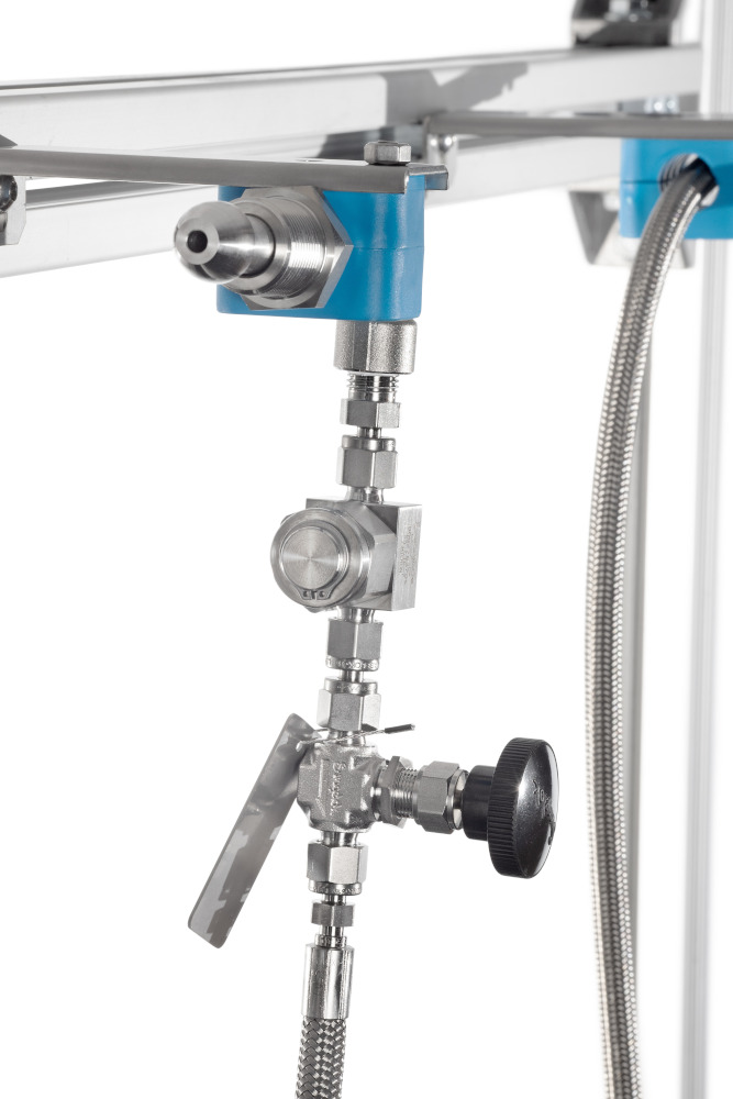

The source inlet (See Figure 2) connects the high-pressure gas source to the gas distribution system. Importantly, the inlet must be built with appropriate cylinder connections, hoses, tubing, filters, vent, purge and relief functions. Some gas panels may not include a standard source inlet. Always verify componentry and that panels will use the correct cylinder connector. Some high-pressure and/or hazardous gases (including oxygen) also require the use of special construction materials.
Figure 2. The Swagelok Source Inlet (SSI) establishes a connection between the high-pressure gas source and the distribution system and ensures that gas can be safely fed into the primary gas pressure control or automatic change over. Courtesy: Swagelok
Figure 2. The Swagelok Source Inlet (SSI) establishes a connection between the high-pressure gas source and the distribution system and ensures that gas can be safely fed into the primary gas pressure control or automatic changeover. Courtesy: Swagelok

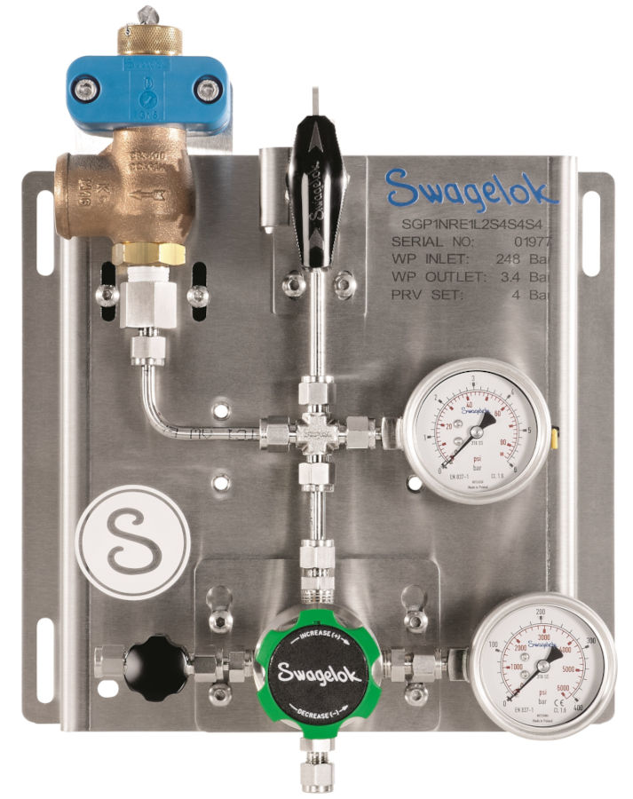

The primary gas pressure control (see Figure 3) completes the first pressure reduction and ensures the source gas is delivered at the correct flow rate to the next stage of the system. Reduction is accomplished with either a single pressure regulator or through a dual pressure regulator arrangement. Pinpointing correct inlet and delivery pressures is challenging. It is impor­tant, for example, to consider the differences between media, such as ammonia that is bottled around 116 psi (8 bar) and nitrogen that can be bottled at 4351 psi (300 bar). Meanwhile, many bottles that use a two-stage pressure regulator may not, in fact, require one. This can be a cost-saving opportunity.
Figure 3. As the primary gas pressure control, the Swagelok Gas Panel (SGP) completes the first pressure reduction of the source gas and ensures it is delivered at the correct flow rate to the next stage of the system. Courtesy: Swagelok

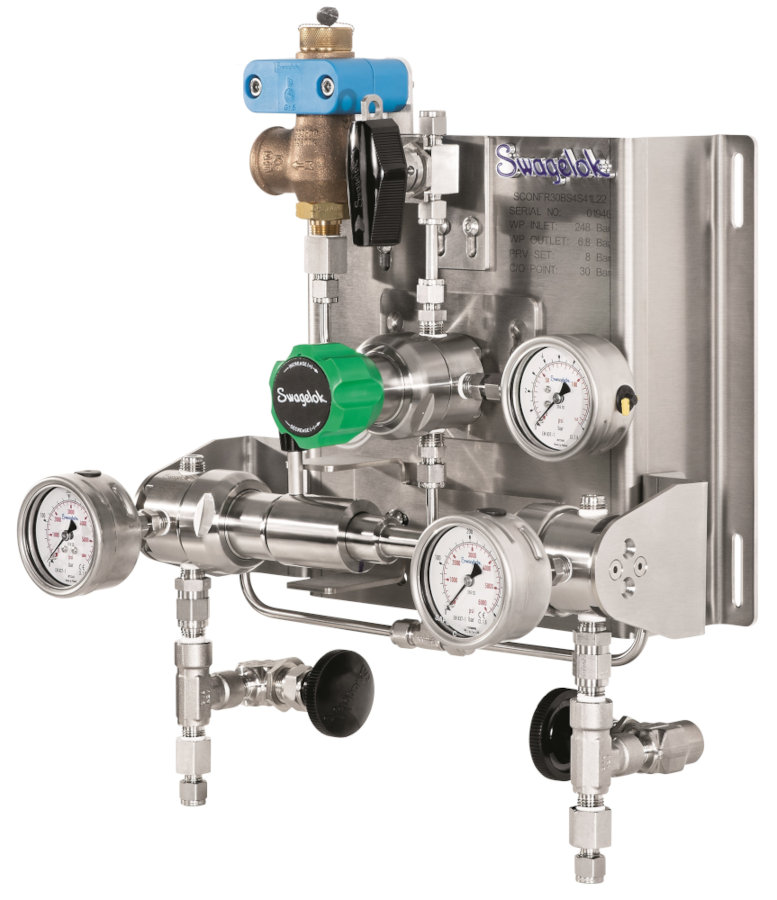

The automatic changeover (See Figure 4) seamlessly switches from one gas source to another to ensure an uninterrupted supply. This is performed through stag­gered set points of two pressure regulators, allowing the system to continue to operate as the primary gas source is changed. It is advisable to look for a solution that allows for varying changeover pressures to get the most use from gas bottles.
Figure 4. The automatic Swagelok Changeover (SCO) system seamlessly switches from one gas source to another to ensure an uninterrupted supply and helps to reduce wasted gas left in cylinders. Courtesy: Swagelok

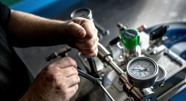

The point-of-use (see Figure 5) provides the critical last stage of control. Typically having a pressure regula­tor, gauge and isolation valve, these subsystems give operators a convenient and accurate method for adjust­ing pressure. Where varying line pressure between the primary gas pressure control and point-of-use is acceptable, a single-stage pressure regulator might be used to reduce cost and complexity.
Figure 5. The Swagelok Point-of-Use (SPU) provides the critical last stage of pressure control prior to the gas being used. Courtesy: Swagelok

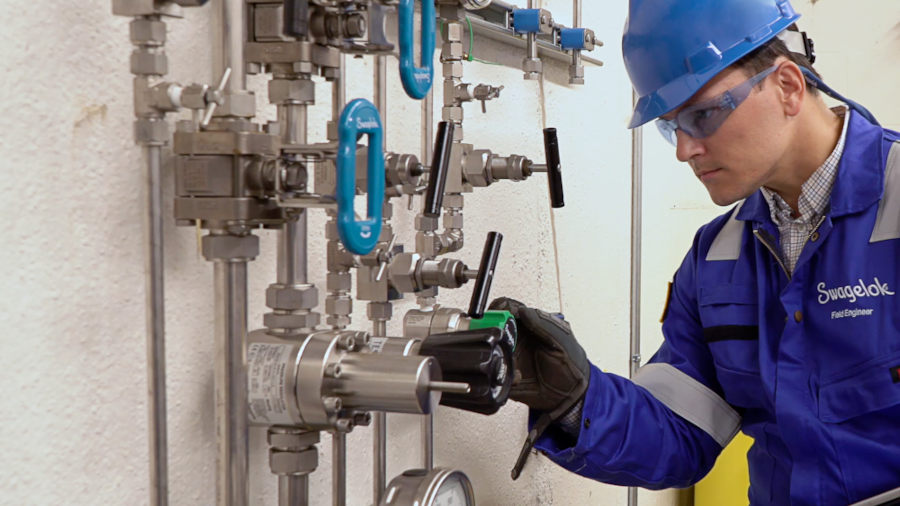

Advisors can also help pre­vent the leakage of toxic and flammable gases, as well as make sure the panels are clear­ly labeled and the instructions are clear. Finally, they can offer guidance on how to design sys­tems properly, so they are easy to operate and troubleshoot (See figure 6).
Figure 6. Third-party field engineers can provide critical analyses to identify system upgrades, inform regulator sizing and selection and guide the design and assembly of engineered solutions. Courtesy: Swagelok
