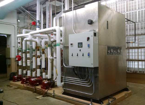

Ammonia chiller packages available
Energy Concepts Company is one of the leading providers of ammonia cycle absorption chillers and related heat exchange equipment. Ellen Makar from Energy Concepts was a recent presenter at a Technology & Market Assessment Forum sponsored by the Energy Solutions Center, providing information about these applications.
Makar explained, "The colder refrigeration you want, the hotter the driving heat is required. For 10°F refrigeration, we need a heat source around 260° F that we can take down to 230°F. For -10°F we need around 280°F to take down to 250°F." She notes that engines or gas turbines can provide ample thermal energy. "Gas turbines are great sources of waste heat because of the hot exhaust." She notes that the Capstone microturbine, with an exhaust temperature of 535°F, can be a very valuable source of heat for refrigeration using an ammonia-cycle chiller.
