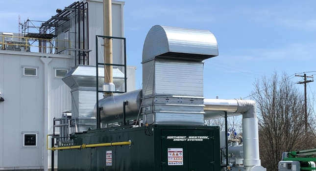

Food manufacturer installs CHP system
Figure 1: Freshpet installed a combined heat and power (CHP) system at their facility in Bethlehem, Pa., which required additional work because of stringent food safety standards. Courtesy: Northeast-Western Energy Systems (NES-WES)
Freshpet is a pet food manufacturer producing fresh pet food that is cooked slowly using steam and then refrigerated. They use a propriety process to produce their preservative-free food from real meat and fresh vegetables, which includes mixing and blending of raw materials, cooking, cooling and packaging.
The process demands large amounts of steam to cook and electricity for refrigeration. Northeast-Western Energy Systems installed a Combine Heat and Power (CHP) system at Freshpet’s Bethlehem, PA., facility, which is utilized to offset the electrical needs of the facility and make use of the exhaust heat from the engine to make steam and reduce the boiler fuel consumption.
“They were looking for sustainability, a hedge on utility rate increases, lowering their carbon footprint and doing something that would be considered green,” said Eric MacBain, business development at NES-WES).
Because it’s a food and beverage facility, there are specific standards that have to be met regarding cleanliness and safety so the company can avoid potential recalls and other hazards.
Purity standards for pet food are the same high level as human food. The system had to be developed, particularly the steam generating capability, to meet these standards.
“We had to ensure during the build and for operations that strict boundaries were maintained to keep their systems clean. The cutovers (electric, steam, feedwater, domestic hot water) for a plant that rarely shuts down operations were particularly challenging and required sacrificing many holidays,” said Adam Masten, vice president of Engineering at NES-WES.
Another challenge during the installation process, Masten said, was the gas tie-in because their existing gas infrastructure was pressure limited and the distance from the gas pipeline riser to the cogeneration unit required extensive routing as a result. He added they could only do the cutovers during major holidays such as Easter, Thanksgiving and Christmas, which made the installation process a challenge. They also had delays due to the switchgear installation, which needed repairs before they could bring everything online. Most importantly were the safety issues because of the strict requirements necessary for food production.
“Since they are manufacturing pet food, they were concerned about any contamination from the CHP System and their product,” MacBain said.
The final installation was a success and the CHP has been able to meet the company’s demands, which are often in a state of flux.
“Since going into operation, the engine and related systems have functions as designed,” said James Gibson, field service manager for NES-WES. “Since the steam is used for cooking, the amount needed changes as well as the volume and pressure. The steam production from a CHP is meant to be consistent, so some changes on the feedwater pump and pressure valve out of the CHP was needed.”
NES-WES, who are no strangers to these kinds of projects, were able to handle the challenges because of their experience.
Tasin said, “It really speaks to how important the true engineer, the guy that’s gonna stamp the system, how much they understand CHP. They’ll look for their local engineer, but they don’t necessarily have that CHP experience.”
