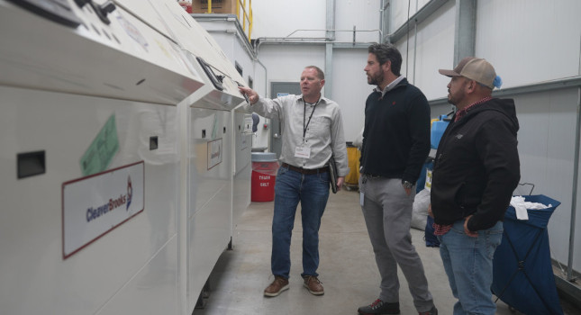

Bradey Day, program manager of TRC Companies, said installing the boilers for Ostrom was a new kind of challenge for them and Cascade, which was contracted to do the installation. They used three ClearFire ultra-high efficiency/low emissions duel fuel natural gas and propane firing condensing hot water boilers from Cleaver-Brooks for the project. They are 96% efficiency a design pressure of 125 PSIG, which allows them to operate in tough conditions.

Ostrom had three high-efficiency condensing boiler systems installed in their Sunnyside, Wash., facility, which were designed to help them reduce overall energy costs. Images courtesy: TRC Companies/Cascade Natural Gas Corporation
Ostrom had three high-efficiency condensing boiler systems installed in their Sunnyside, Wash., facility, which were designed to help them reduce overall energy costs. Courtesy: TRC Companies/Cascade Natural Gas Corporation

The three boilers amounted to almost 10 British thermal units (BTUs) for the entire 43-acre facility, which was a high for the company installing the boilers.
“I think the scale of the units themselves and how efficiently they run and how this can be replicated at other properties,” Day said, noting the three installed boilers were 3.3 million British thermal units (BTUs) each. “That’s almost 10 million BTUs. Our typical project is 250,000 BTUs. The scale of the project is unique and it was cool to see how it could be used in so many different applications. Generally, boilers are used for space heating or water heating. These were used for the entire facility.”
The annual savings for Ostrom amounted to 91,980 therms per year as well as incentives for the energy savings. These savings help Ostrom can focus on growing quality, sustainably produced mushrooms rather than worrying about rising energy costs, which are becoming a growing concern throughout.
