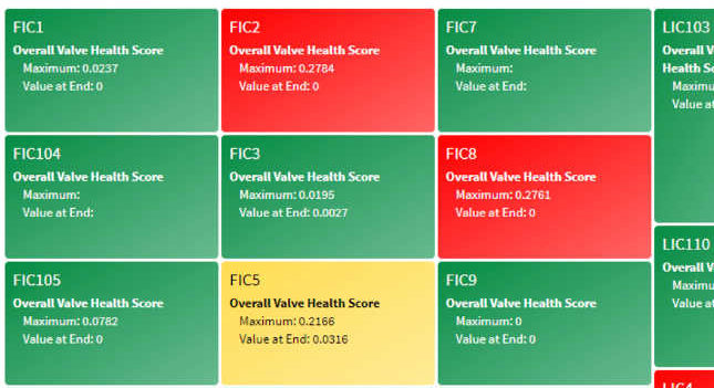

Next, the company’s data scientists scaled up the model, building an asset hierarchy of all valves in service. Collaborating with reliability engineers and process SMEs, they classified each asset by variables and model assumptions, both required so users could sort by type and leverage roll-up views—such as treemaps—across assets (Figure 1).
Because it is cloud-based, this advanced analytics application housed more than enough computational power to scale the model from one control valve to thousands of valves throughout the organization.
