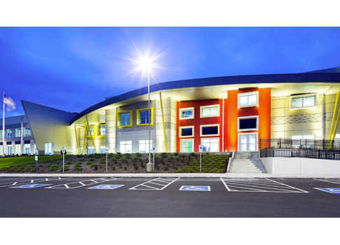

4. Design an environment that makes your employees want to come to work every day.
Fredericksburg, Pennsylvania is a small township, home to a population less than 1,000. Needless to say, Bell & Evans is a big part of it, which is why Sechler wanted to make the new plant something both the community and his employees could enjoy.
From the outside in, the building doesn’t look like a typical food processing plant. The front of the facility is brimmed with a large-entrance canopy overhanging an employee courtyard area. Yellow metal columns are spiked beneath the canopy, while a mix of yellow and white shadow boxes adorn the front-facing glass windows, which are dipped in a blue glaze. An immaculate wing wall (an aesthetic addition) breaks up the courtyard and the employee cafeteria located inside the building.
Features in the plant’s main entrance and lobby set the tone for the enjoyable environment Sechler wants associated with Bell & Evans:
  • The lobby’s walls are adorned with oversized porcelain tile, rather than plain drywall
  • The floors are painted with a customized epoxy paint chip mix featuring the company colors
  • A frosted glass partition is situated in the grand, first-floor employee conference room, separating the large space into smaller areas for employee training
  • The bathrooms are designed with high-end fixtures, including granite trough sinks
  • 8Ă—8-feet windows overlooking the plant processing area give the offices a modern, artistic flare
  • An outside courtyard area is designated for employees taking breaks or who wish to enjoy their lunches in the great outdoors
