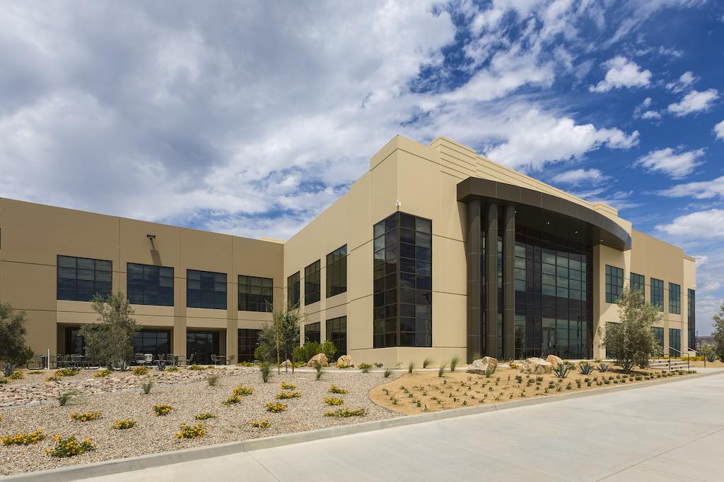

Specialty refrigeration and critical utilities can result in cold storage facilities cost three to four times more than regular dry facilities. Courtesy: Graycor

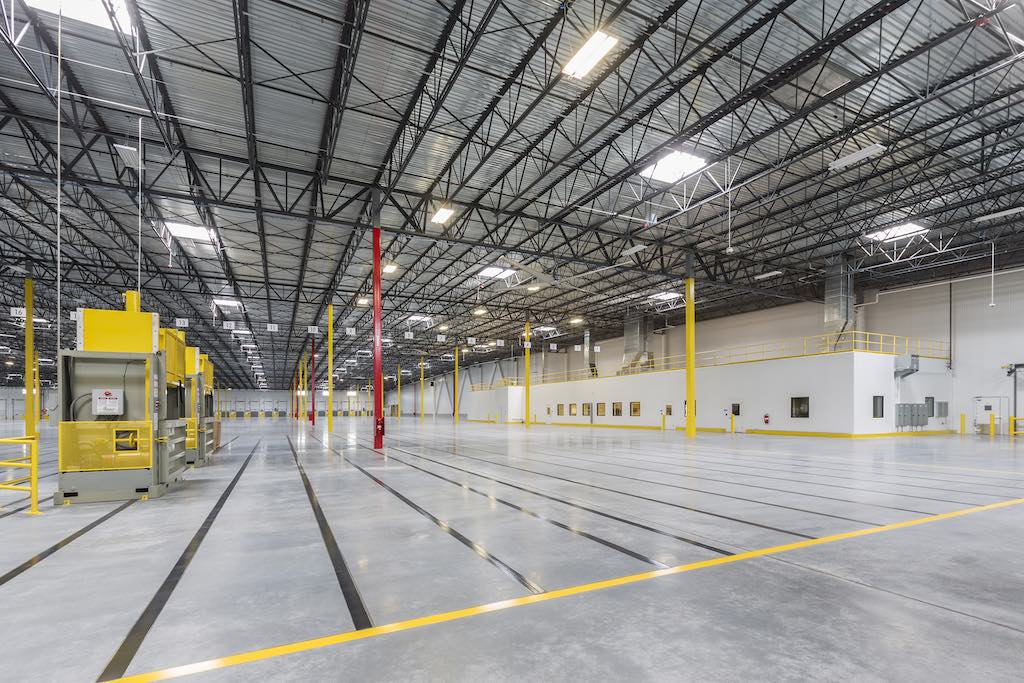

Sophisticated temperature control systems are required to ensure the correct environment for storing foods of various types, ranging from frozen food to fresh produce. Courtesy: Graycor

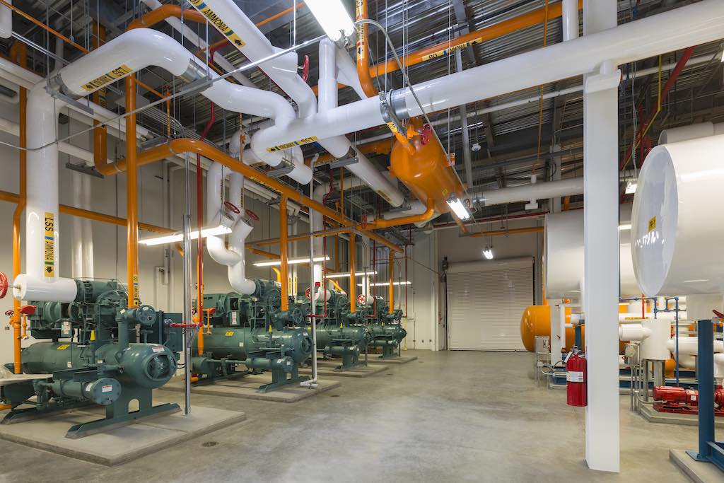

Refrigeration is arguably the most important element to cold storage facilities and it is an industry that’s changing quickly. For example, liquid recirculation systems and hydrofluorocarbons, known by most as HFC, are being phased out in favor of more environmentally friendly alternatives like low-charge ammonia-based systems, carbon dioxide refrigerants and hydrofluoroolefins aka HFO.
The type of refrigeration needed must be determined early in the preconstruction stage. Refrigeration needs to satisfy product-specific requirements, which vary by the types of items being handled and the length of storage. The logistics of moving items from one level of refrigeration to another, which would be the case in ripening fruit, for example, must be considered as well.
Refrigeration equipment often is manufactured and assembled off-site and comes in many capacities with various mounting configurations that fit into a wide range of spaces. Refrigeration must be installed as the building is erected to accommodate space restraints and the limited access that will be available in the finished building, especially in vertical cold storage warehouses.
