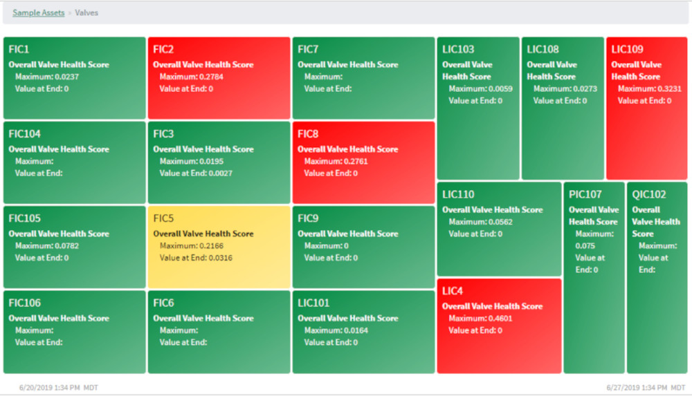

In one case, engineers at a chemical company were looking to improve their control valve maintenance strategy. They decided to evaluate whether or not a predictive maintenance program could reduce costs incurred from frequent and unplanned feed valve servicing. The hope was for a model-based predictive maintenance strategy that could be deployed across all the company’s control valve assets, which are critical to product quality.
With advanced analytics, the engineers collaborated with data scientists to create a model comparing the theoretical and operational valve-flow coefficient of one control valve. Conditions in the algorithm were used to identify periods of valve degradation in addition to past failure events. By reviewing historical data, the SMEs determined the model would supply sufficient notification time to deploy maintenance resources so repairs could be made prior to failure.

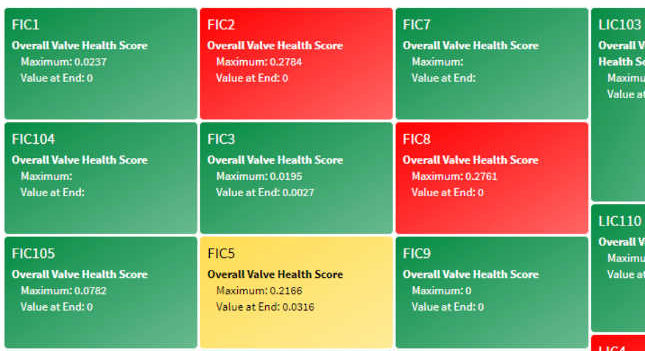

Next, the company’s data scientists scaled up the model, building an asset hierarchy of all valves in service. Collaborating with reliability engineers and process SMEs, they classified each asset by variables and model assumptions, both required so users could sort by type and leverage roll-up views—such as treemaps—across assets (Figure 1).
Because it is cloud-based, this advanced analytics application housed more than enough computational power to scale the model from one control valve to thousands of valves throughout the organization.
Figure 1: A treemap displays a chemical company’s critical control valve health scores within a production unit. Courtesy: Seeq

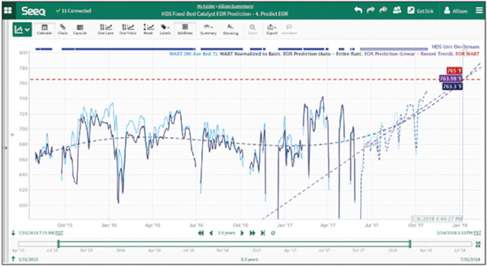

Over time, the fixed bed catalyst used in hydrodesulfurization units degrades, impacting product quality until it is replaced. While the weighted average bed temperature (WABT) is often a key metric used as a proxy to indicate catalyst bed health, creating an accurate WABT model for optimized production is difficult because it can fluctuate due to process variables, including composition and flow rate. For this reason, data scientists must apply cleansing techniques to the calculated WABT model prior to plotting to create a suitable data set for the regression algorithm (Figure 2).
Figure 2: The chart compares a full data set with a recent sample set of weighted average bed temperature predictions, both indicating maintenance will be required in the coming months. Courtesy: Seeq
Engineers at an oil and gas company needed to determine if the degradation of the catalyst bed on a hydrodesulfurization unit had accelerated in recent months. The team calculated and extrapolated multiple regression models to predict the required maintenance date.
After analysis, it became clear the degradation rate had accelerated in recent months and the original time-based catalyst change out would not come soon enough if they continued operating at current rates. This analysis justified an early catalyst change, alleviating months of constrained rate operation, and saving more than $5 million.

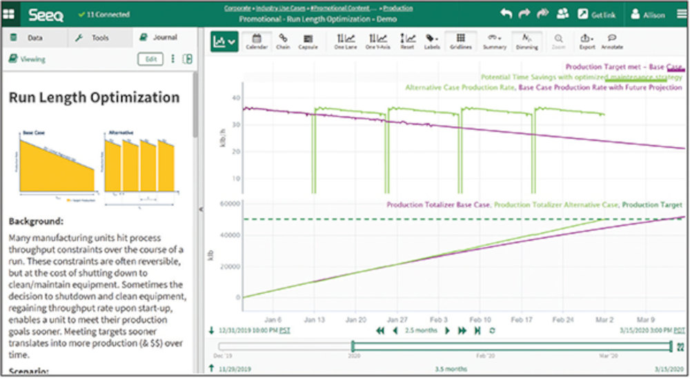

Process effects, including catalyst degradation and fouling, can constrain production rates throughout the course of a manufacturing run. This is often the case for polymer production processes.
As portions of produced material begin to coat the insides of pipes and vessels, defouling is required so accumulation buildups do not impact flow or increase the pressure delta to where damage is caused to upstream equipment. Most buildup can be reversed via online or offline procedures that apply heat to the coated equipment, melting off the foulant layer.
A large polyethylene producer was experiencing production rate degradation due to fouling, and was investigating a way to optimize its defouling strategy to increase production and fulfill customer orders sooner.
A team of SMEs created a regression model using the degradation rate to forecast when production targets would be met if no action were taken. Next, they compared this to an alternative model incorporating defouling procedures, and then calculated the number of defouling cycles required to minimize the total time to produce a given order size. Once this was identified, engineers created a golden profile for the optimal number of future cycles between defouling procedures (Figure 3).
By deploying this online model in the advanced analytics application environment, plant personnel could trace the forecast during actual production to indicate when to execute the next defouling procedure. This strategy enabled a continuously booked production unit to fulfill orders at an average of 11% sooner over the course of the following year, empowering it to gain significant market share.
Figure 3: This chart depicts the optimization problem (top) and its graphical solution (bottom) in Seeq analytic software. Courtesy: Seeq
