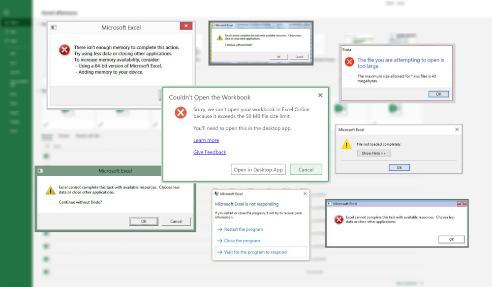

With data finally in hand, the complexity of analysis will be limited by access to applications, knowledge of advanced analytics and ML algorithms and available time. Many engineers have become adept at manipulating a spreadsheet to explore and analyze data, and they are eager to expand their skill sets in this area. However, the job of the front-line engineer is one of many competing priorities, typically leaving minimal time to focus on developing complex analyses, especially when using spreadsheets, a tool not designed for the task (see Figure 1).

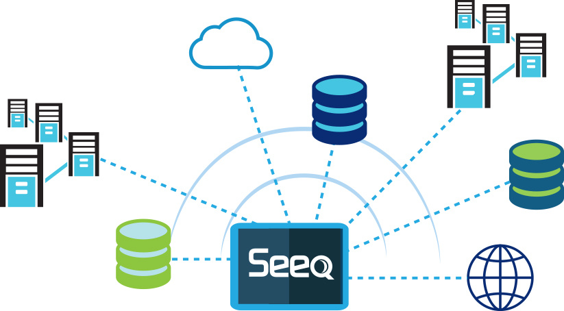

Advanced analytics applications connect to all relevant data sources (e.g., process, lab and maintenance) using a suite of connectors. This provides access to data from where it is currently stored, without the need to copy, and then store it in a data lake or the application. Furthermore, advanced analytics applications connect to multiple data sources simultaneously. Implementation of the solution does not depend on IT departments completing their data projects. Instead, as those new data stores come online, the application can be updated to use them (see Figure 2).

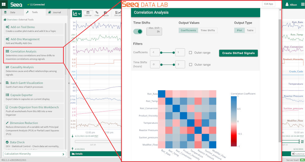

One process engineer at an oil and gas company questioned the existing models, which indicated they needed to limit their purchase of poor-quality feedstock during the summer months. Using Seeq’s advanced analytics application, the engineer found periods of similar and dissimilar operation during both summer and winter months and was then able to cleanse the data and generate a new model based on actual plant data and seasonal operation (see Figure 3).
Figure 3: Using Seeq, an engineer developed a correlation algorithm and deployed it as an add-on tool to identify input signals with greatest effect on operations.
Figure 3: Using Seeq, an engineer developed a correlation algorithm and deployed it as an add-on tool to identify input signals with greatest effect on operations. Courtesy: Seeq
Using the new model, the engineer determined the plant could process two to three times as much poor-quality feedstock. The analysis and results were then summarized in a report for review with management, and they decided to purchase additional poor-quality feedstock, resulting in a realized value of more than $1 million per year.
