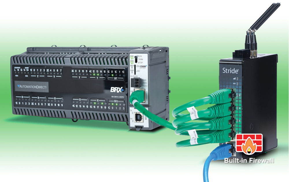

Remote connectivity and monitoring solutions for industrial IIoT projects must include hardware and software elements to connect with all OT data at a site and transport it to the cloud. One of the best architectures for this involves an intelligent router on site, connected seamlessly to a cloud platform via the internet (see Figure 2).
Figure 2: An AutomationDirect StrideLinx router can seamlessly connect with PLCs and HMIs on-site, providing a cloud-capable remote connectivity and monitoring solution. Courtesy: AutomationDirect
Not only must the router support all standard OT communication protocols, but users should be able to configure and download router settings from the cloud without visiting the site or adjusting the target PLC programs. A connectivity solution of this type can be added to any installation without impacting the underlying and existing automation systems, and it can be optimized for logging both real-time and historical data to the cloud (see Figure 3).
Figure 3: AutomationDirect StrideLinx VPN routers are optimized to work on-site and accessPLC data, and then transmit it efficiently and securely over the internet to the StrideLinx cloud platform. Courtesy: AutomationDirect
