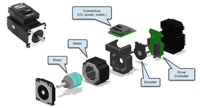

Mechanical and electronic systems traditionally worked as physically separated units. The motion control arena experienced a huge change in this regard in the mid-1990s when electric motor and control integration came on the scene in a big way (Ref 10). A flurry of products was introduced by many manufacturers — first as combinations of ac induction motors with VFDs in one package, so-called integrated motors. Then similar combined units became available for servo and stepper motors and their respective controllers (Ref 11).
Various benefits can be attributed to having control electronics onboard motors — for example, lower installation costs without long cabling between motors and drives and associated conduit trays, fewer system components, easier diagnostics and maintenance, and simpler control architecture (Ref 12). However, integrated motors have experienced less success than expected, mainly in the induction motor and drive sector. Perhaps this is due to fewer favorable applications or user ambivalence. Still, these induction motor/drive combinations remain in the market for sizes up to 22 kW, serving appropriate applications and in hybrid control architectures.
On the other hand, integrated servo and stepper motors have done better. More suppliers are providing these units with more product sizes being introduced. A case in point is a very recent example of integrated motors development (Ref 13). Smaller physical size and power of these integrated motors also favors more applications.
